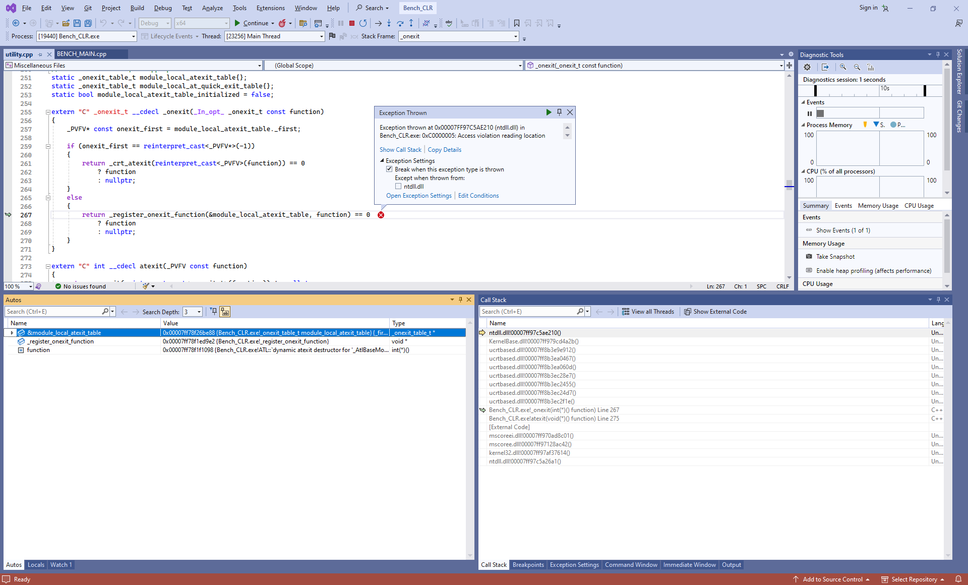

  3. Dahl, Oskar 20 Reputation points
    2024-01-19T15:50:37.88+00:00
    Here is a printscreen of how the crash looks. I will try to produce some kind of minimal sample, but it will take time. I just wish it was possible to install older visual studio products for cases like this.
