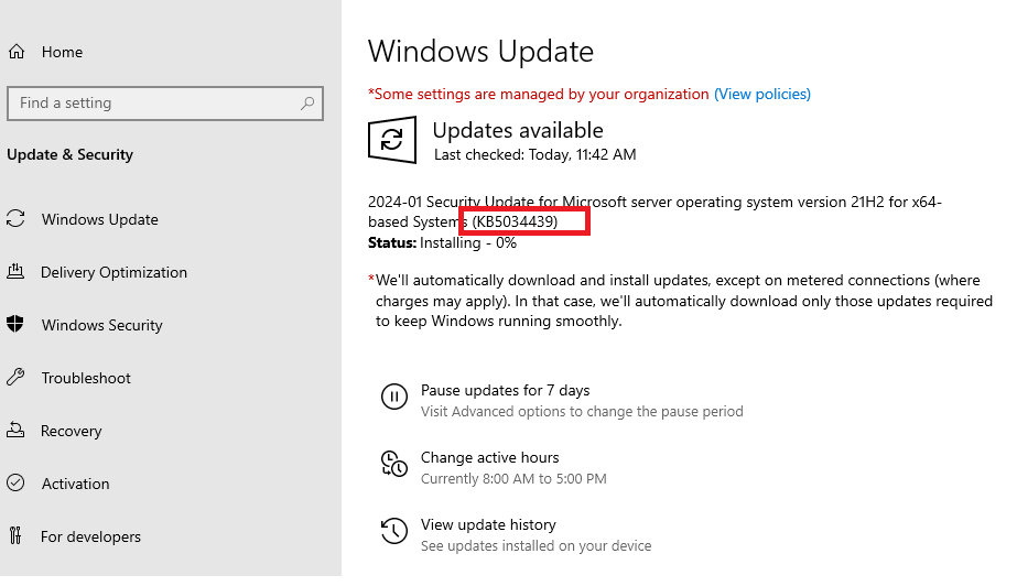

Hi, There was a download issue to the following update. Any help? User's image

    It was recently reported that the Windows Server 2022 Security Update KB5034439, which was released as part of Patch Tuesday to address a BitLocker encryption bypass (CVE-2024-20666), has been failing. The failure occurs when there are issues with the Windows RE partition and deployment, preventing the update from being installed. Indeed, a known issue has been identified with KB5034439. The update fails to install on a PC without a recovery partition, resulting in the error 0x80070643 ERROR_INSTALL_FAILURE. However, if your PC does not have a recovery partition, this update is not necessary. Therefore, in such cases, the error can be disregarded.

    Hello For the downloading issue, we could try the following steps:
    1. Run the update troubleshoot tool. Settings > Update & Security > Troubleshoot > Additional troubleshooters > Windows Update
    2. Reset Windows update cache manually. Here is the link for reference: Additional resources for Windows Update - Windows Client | Microsoft Learn If the issue persists, we may try to open administrator powershell command line then run "get-windowsupdatelog" for more details to troubleshoot the issue. In addition, there could be known issue with KBKB5034439. KB5034439: Windows Recovery Environment update for Azure Stack HCI, version 22H2 and Windows Server 2022: January 9, 2024 - Microsoft Support
