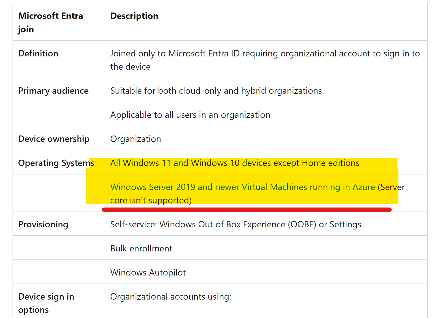

    As per Microsoft Entra joined devices documentation server join is not entirely supported nor a recommended way.
    • However if your VM is hosted on Azure then the recommended way would be to use Entra ID extension.
    ***Please "Accept the answer (Yes)" and "share your feedback ". This will help us and others in the community as well.
