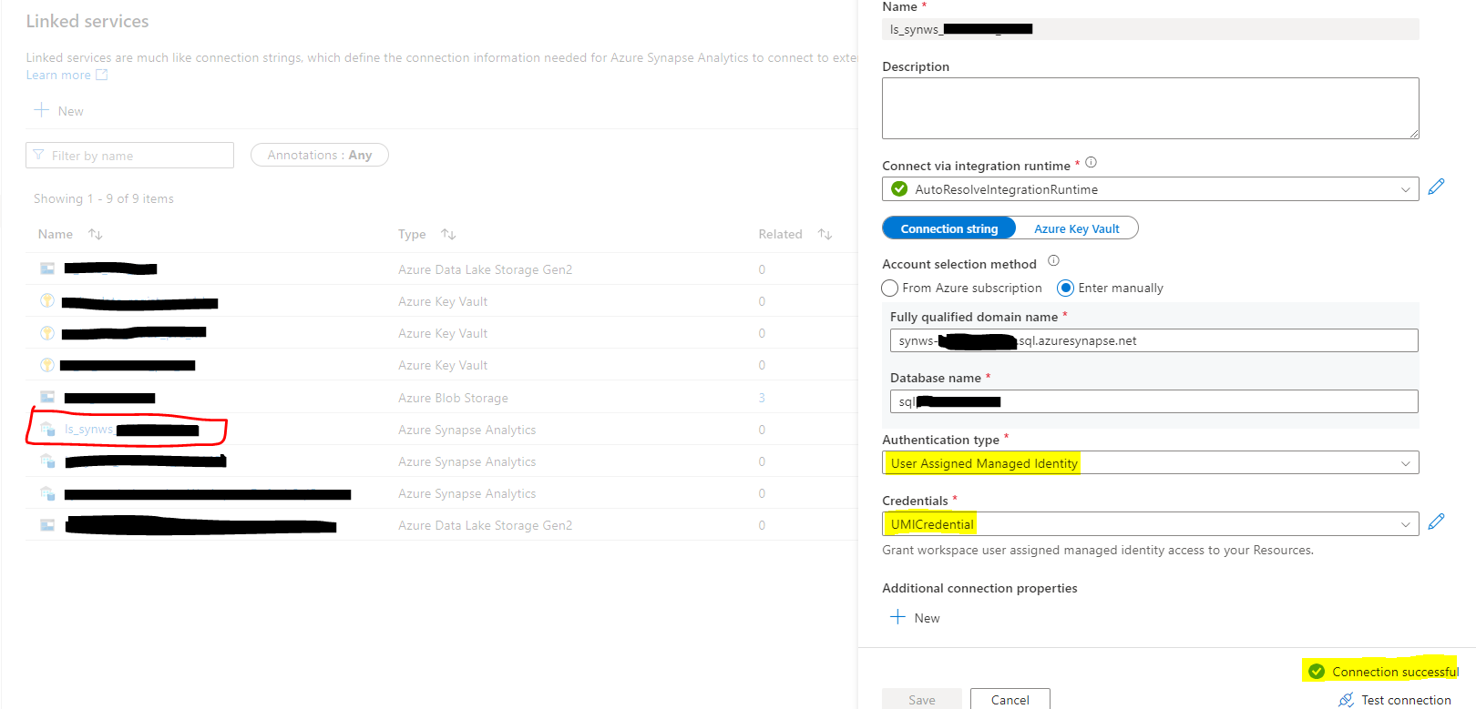

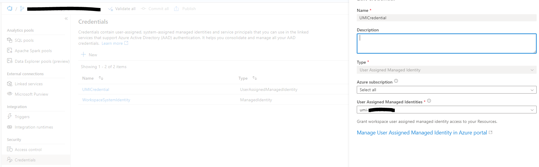

which added successfully the user with access and write,read permissions: User's image In my synapse workspace I created a credential in Manage>Credentials pointing to my umi-key-name User's image
Then I created a linked service pointing to the SQL dedicated pool and using the umi-key-name as the user managed identity credential and the connection is successful: User's image And when I run the following code in the notebook, I am not able to connect to the SQL DB:

    Directly using the linked service name in JDBC connection properties is rare. In most cases, the linked service is utilized in data factory pipelines rather than directly connecting to notebook JDBC.
    For movement in the notebook, rather than a direct connection via JDBC, consider using Azure Data Factory to orchestrate data. It is possible to establish a pipeline that uses the linked service and UMI for authentication.
