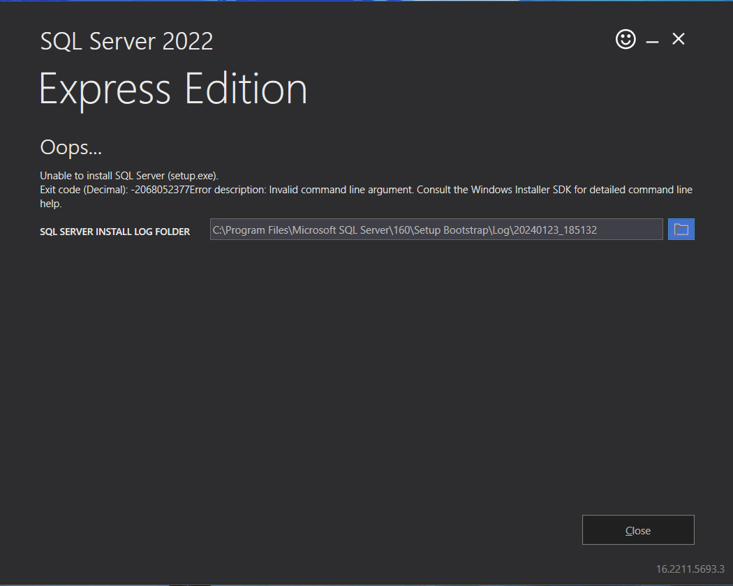

ERRORLOG.txt How to fix Unable to install SQL Server. Exit code (Decimal): -2147467259 the system cannot find the path specified
Otis 20 Reputation points
2024-01-22T13:43:51.4466667+00:00
SQL Server | Other
  1. Erland Sommarskog 128.7K Reputation points MVP Volunteer Moderator
    2024-01-22T22:20:31.74+00:00
    I see that you get the error message Wait on the Database Engine recovery handle failed is a generic error that means that SQL Server did not start when Setup wanted to run configuration steps. To understand why it did not start, you need to look in the SQL Server errorlog, which you find in C:\Program Files\Microsoft SQL Server\MSSQL16.MSSQLSERVER\MSSQL\LOG\ERRORLOG.
    If you see a message about 256 misaligned reads, you are running into a known issue where Windows 11 for some disk drives reports a sector size that SQL Server does not cope with. Microsoft has published an article with workarounds for the problem.
    If you don't see the message about misaligned reads, feel free to upload the errorlog here, so we can look at it. You will need to rename to ERRORLOG.txt for the forum software to accept it.

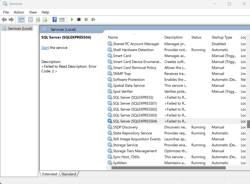

  1. ZoeHui-MSFT 41,536 Reputation points
    2024-01-23T05:19:54.6266667+00:00
    Hi @Otis,
    Please follow the below steps to remove all components of previous installed SQL Server completely:
    1. Remove all SQL Server components from 'Programs and Features'
    2. Backup the registry
    3. Delete the following keys in regedit:
    --HKEY_LOCAL_MACHINE\SOFTWARE\Microsoft\Microsoft SQL Server
    --HKEY_LOCAL_MACHINE\SOFTWARE\Microsoft\MSSQLServer
    1. Go to HKEY_LOCAL_MACHINE\SOFTWARE\Microsoft\Windows\CurrentVersion\Uninstall and delete all the sub-keys referencing SQL Server
    2. Go to HKEY_LOCAL_MACHINE\SYSTEM\CurrentControlSet\Services and delete all the keys referencing SQL Server
    3. Reboot the machine In addition, please use an administrator account to reinstall SQL Server on your computer (Right click->run as administrator).
