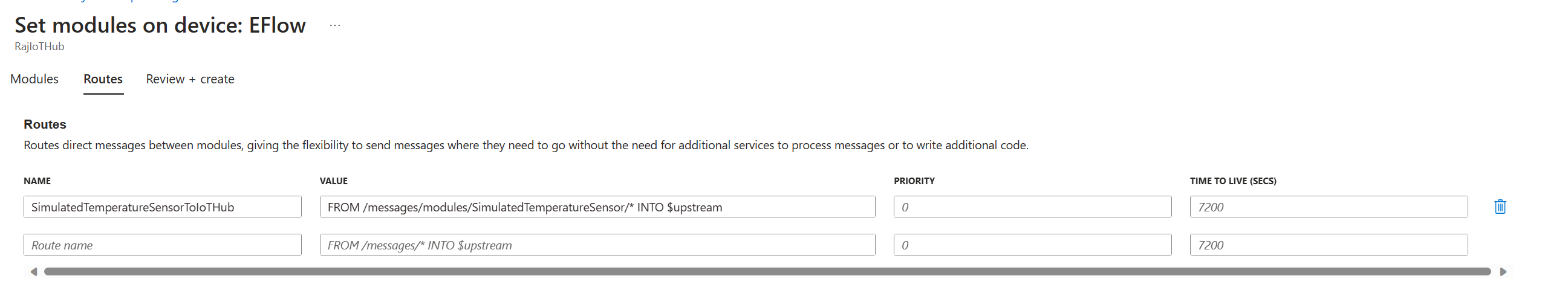

    Considering you have multiple IoT Edge devices, it would not be ideal to create Edge Blob storage modules on each of your devices. Instead, you can use routing on your IoT Edge modules and push the data to the IoT Hub. You can easily add routes to your modules from Azure portal Set Modules pane of your IoT Edge device. Here is an example of a route that pushes all device to cloud messages from a particular module of Edge device to IoT Hub.
    enter image description here
    You can then use IoT Hub routing to route all this messages to any built-in end point such as Event Hub. If you are flexible with your end point DB, IoT Hub supports Cosmos DB routing out of the box. You can simple follow the steps provided in the following article Routing in IoT Hub
