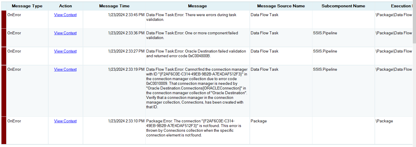

Hi, we have an SSIS package that includes a data flow task to retrieve the data from the OLEDB source(SQL Server) using SQL command, goes through sorting to remove duplicates, and stores it in the OLEDB destination(Oracle DB). The issue is with the OLEDB destination. the data access mode "Table or view - fast load" is throwing an exception whereas "Table or view" is not throwing any exceptions. Error while using "Table or view - fast load" :User's image
While using "Table or view" the package is getting stuck at "execute phase beginning"
I have set the delay validation property to true and ValidateExternalMetadata to false for every component. Does anyone have any idea on how to fix the issue? Regards, Karthik.

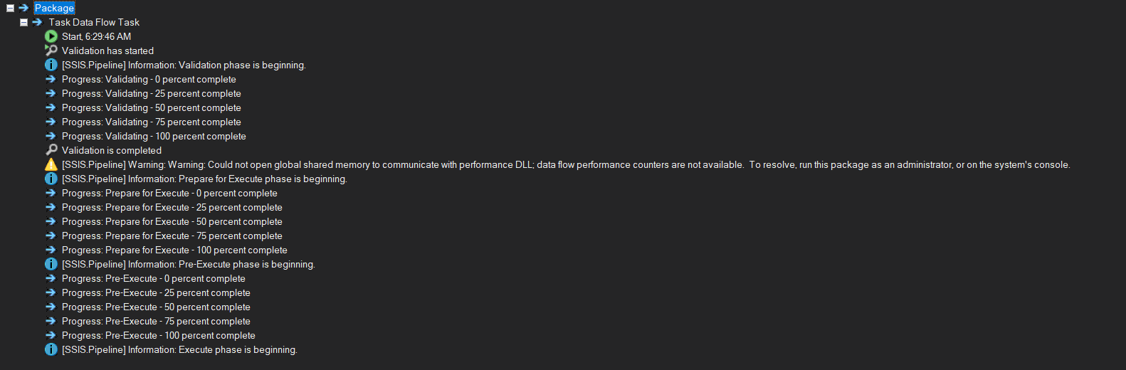

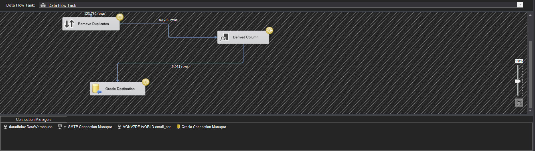

  2. Karthik Ponugoti 0 Reputation points
    2024-01-23T19:52:06.4833333+00:00
    @Yitzhak Khabinsky The package is stuck in the execute phase beginning and the data flow components remain in yellow color.User's image
