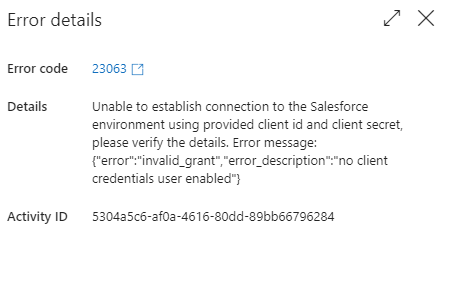

Unable to establish connection to the Salesforce environment using provided client id and client secret, please verify the details. Error message: {"error":"invalid_grant","error_description":"no client credentials user enabled"}

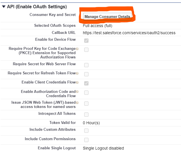

    • Make sure that you have created a connected app in Salesforce and obtained the client ID and client secret. If you have not done so, please follow the instructions in this Salesforce documentation to create a connected app.

    I believe this issue is related to the use of "OAuth 2.0 Username-Password" in salesforce backend, if we move it to "OAuth 2.0 Client Credentials". That should solve the issue. Kindly reach out to relevant salesforce teams in your org.

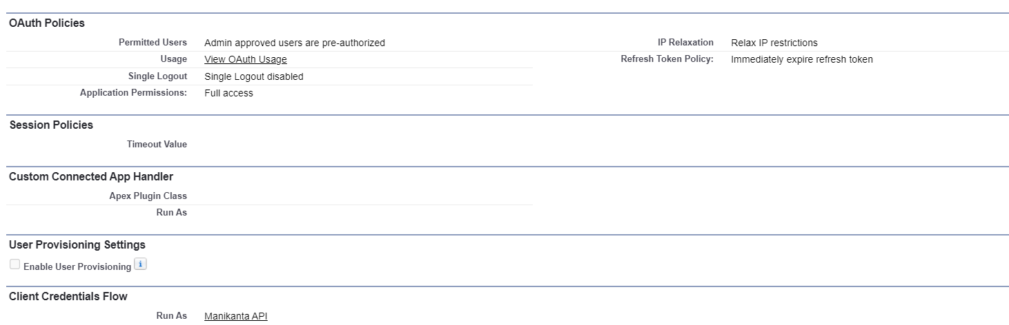

  3. JJ Lucarelli 26 Reputation points
    2024-06-07T13:14:51.69+00:00
    Be sure to assign a user to the correct "Run As" field on the connected app in Salesforce. My issue was that I added the user to the first "Run As" field I saw and it was for Custom Connected App Handler when it is supposed to be the one for Client Credentials Flow. :-)
