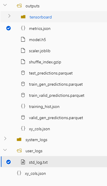

Below is the folder structure in the output of a job and trying to download metrics.json User's image
ml_client.jobs.download(name=job_name,output_name='outputs/metrics.json')
` The above does not download the file nor raise any exception. `
ml_client.jobs.download(name=job_name)
` The above one downloads all the file which are in the output. Am I missing anything while trying to download single file.
