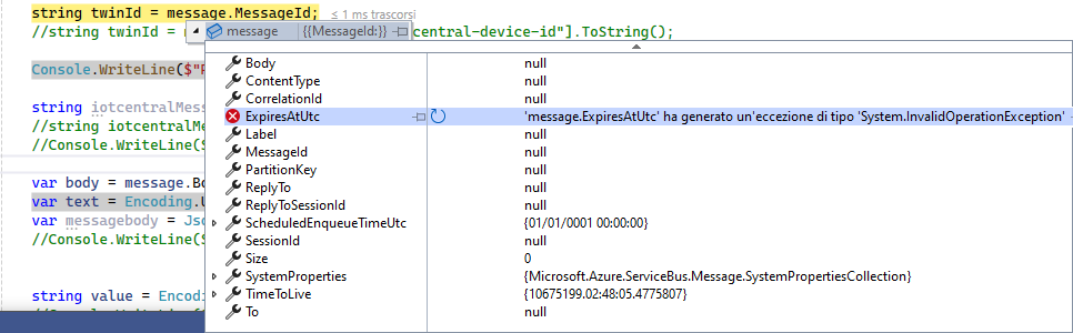

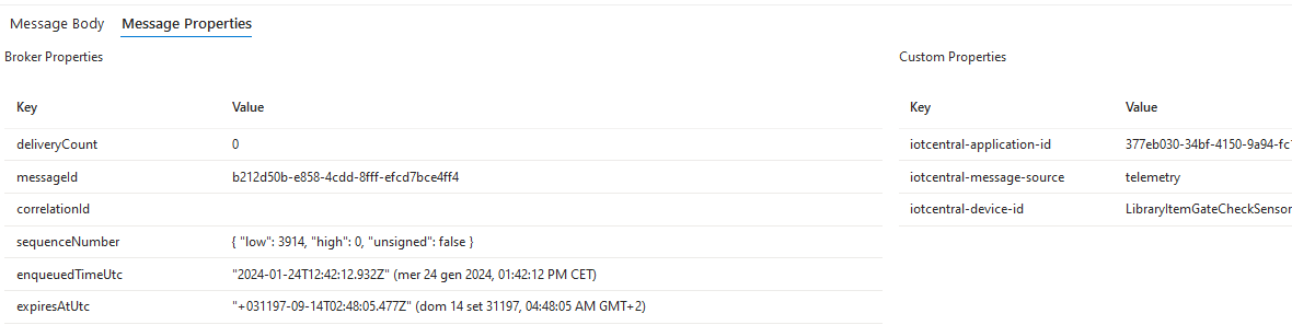

Hi, in the question about "How to update a digital twin object property using Azure Service Bus queue data from an Iot Central device" at https://learn.microsoft.com/en-us/answers/questions/1290036/how-to-update-a-digital-twin-object-property-using i accepted answer of @LeelaRajeshSayana-MSFT . I would like to point out, however, that I use Microsoft.Azure.ServiceBus 5.2.0 in IotCentralTrigger.cs file but the nuget packaged is deprecated and Visual Studio suggests that Azure.Messaging.ServiceBus should be used instead. Now if i run the code i obtain the ExpiresAtUtc = 'message.ExpiresAtUtc' ha generato un'eccezione di tipo 'System.InvalidOperationException' . Look at the following snaphosts. Debug: immagine Messages properties in Azure Service Bus queue: immagine
What would be an alternative code example to IotCentralTrigger.cs that now needs Microsoft.Azure.ServiceBus 5.2.0 to manage the following "Message message" istruction to avoid the error indicated?

    If I look at the screenshots you provide, that expiration date looks very strange:
    I have the impression that the first plus sign is not valid in a regular UTC notation of a DateTime. Are you able to fix this and try again?
