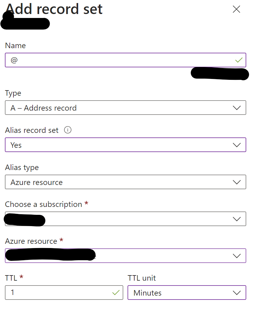

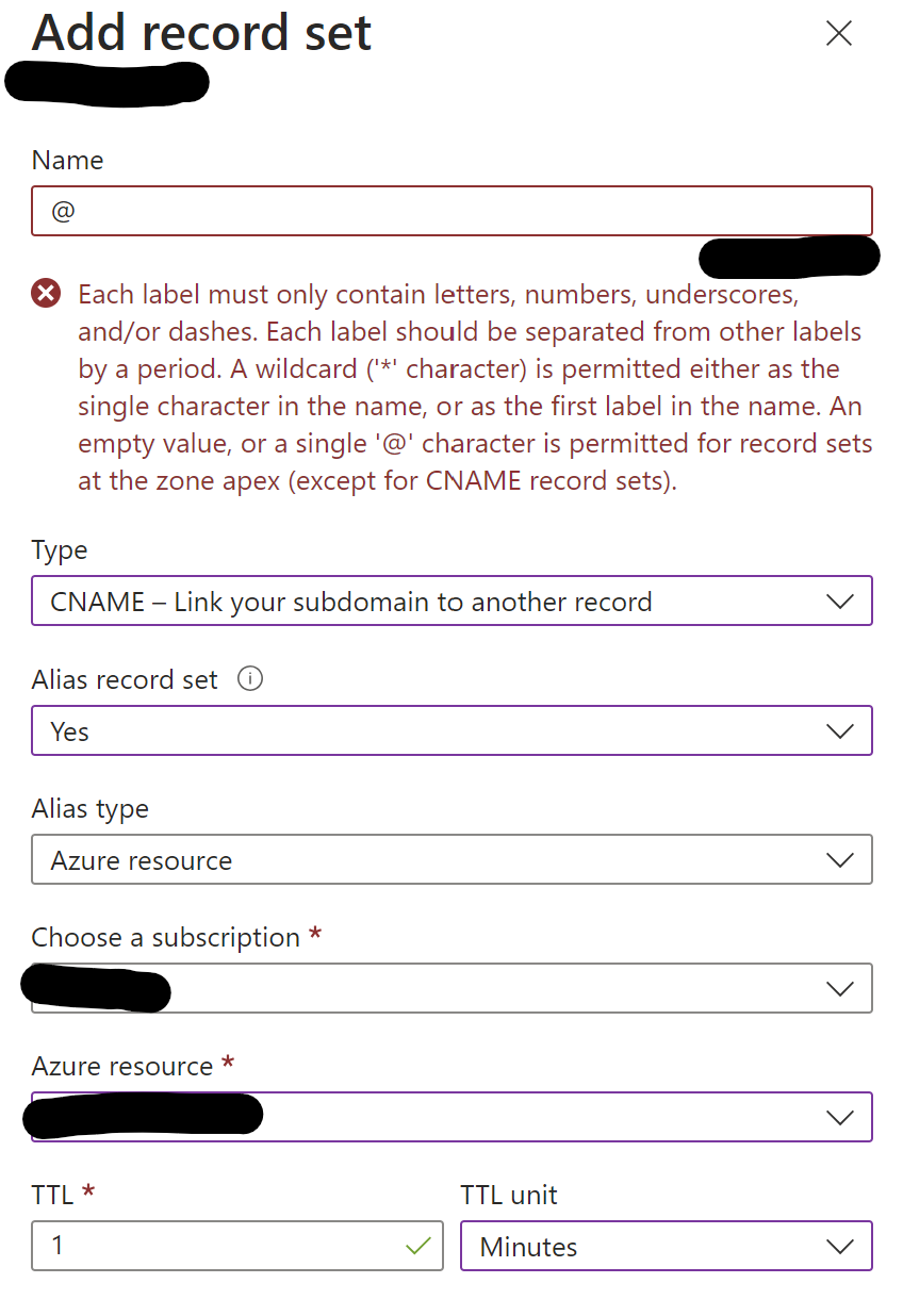

Hi there, I have configured the custom domain for my static web app like described here: https://learn.microsoft.com/en-us/azure/static-web-apps/custom-domain-azure-dns For the subdomain www.example.com it's working fine (SSL also there), but for my apex domain example.com it's not working, always get a certificate error. In the static web app, my apex domain is validated (green checkmark), but under action I still have "Add a CNAME, ALIAS or A record", but I already added the A record like described. What could be the issue here?

    You don't want to use A record with static web app. Use either CNAME or ALIAS. With this in mind, I suggest deleting the A record, adding a CNAME with TTL as low as possible (e.g. 30 seconds, 1 minute), waiting several minutes, and then testing.Depending on the previous TTL, you may need to wait for several hours for the old DNS record to expire. To combat this you could test using a different DNS server for name resolution on your local workstation, or maybe use a different network connection that you never tested from before.
    On your local PC, you want to be able to run below command and get canonical name response that points to the static web site FQDN as shown in the portal:
    nslookup <yourapexdomain.com>
    If it still shows the previous IP address then you know DNS record hasn't propagated to your local PC's DNS name resolution server.
    In some cases I've had to delete the domain out of the portal, delete the relevant DNS records for that domain (TXT, A, CNAME, ALIAS for the apex), wait 15 minutes, then add the domain back, generate code, create TXT record, wait for it to verify, create CNAME record, then finally wait for it to be done and verify that certificate is correct on site.
