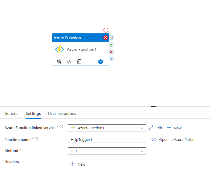

Hello everyone, I was trying to create an Azure Function using Python that:
  • obtains a key vault connection using the function app's managed system identity (MSI) (my implementation stores the key vault URL in a function app application setting called KEY_VAULT_URL)
  • obtains the value of the “GoogleAnalytics” secret (the contents of the Google service account's private key JSON file)
  • creates a credential using the service account's private key, scoped to https://www.googleapis.com/auth/analytics.readonly (this scope is required to access the analytics API endpoint)
  • requests an access token from Google's OAuth 2.0 service [line 23] then returns it in a JSON response

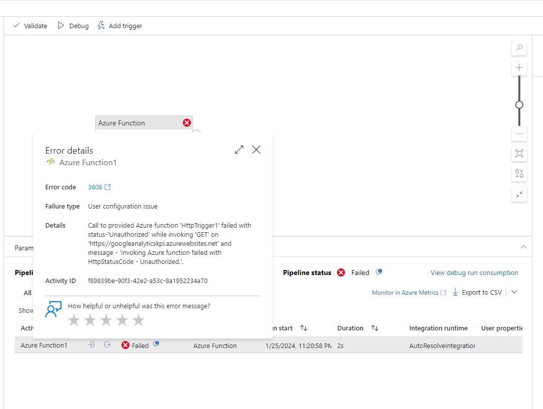

The problem is that after creating this function and trying to run it using Azure Data Factory, I got this error and i don't know the reason : Call to provided Azure function 'HttpTrigger1' failed with status-'Unauthorized' while invoking 'GET' on 'https://googleanalyticskpi.azurewebsites.net' and message - 'Invoking Azure function failed with HttpStatusCode - Unauthorized.'. I really need an urgent help on this. Thank you

  1. Ryan Hill 30,326 Reputation points Microsoft Employee Moderator
    2024-01-30T17:39:38.6766667+00:00
    Hi @Wajih Arfaoui
    Apologies for the late reply. At first glance, it appears you're not passing the appropriate key to the function. The key/code is required if you don't configure your function for anonymous access. See Manually run a non HTTP-triggered Azure Functions | Microsoft Learn for more information, but you need to add the function key as x-functions-key to the request header.
