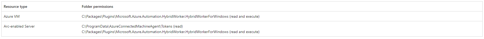

    7. If the following permissions are not assigned for Custom users, jobs might get suspended.
