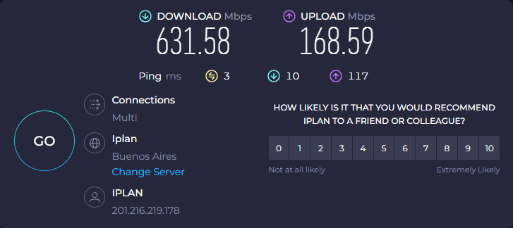

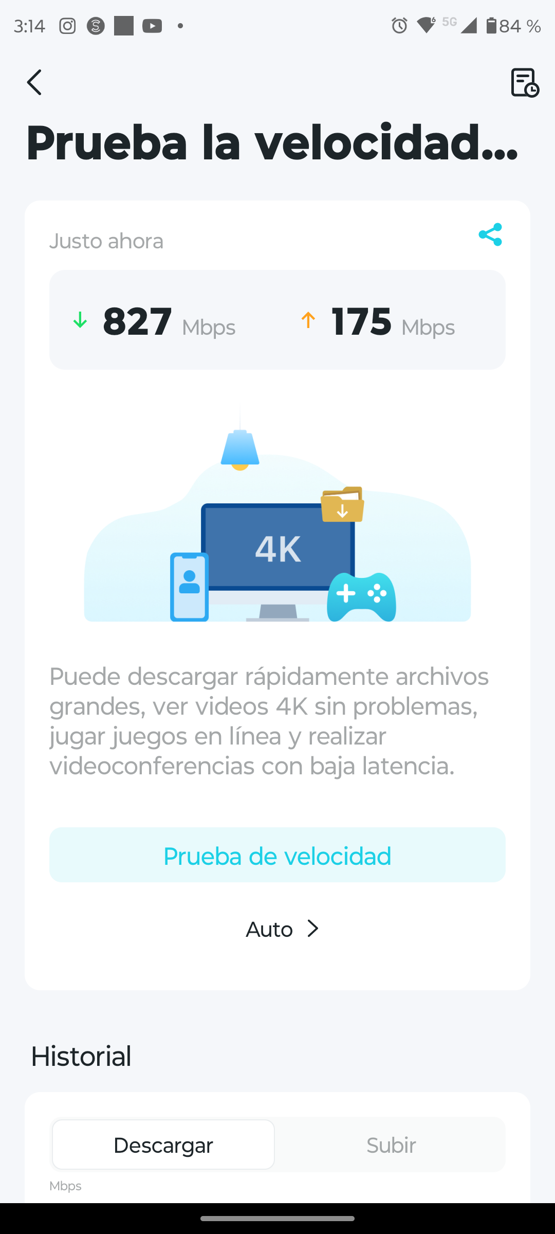

Hello dears I have been struggling for a few weeks with this problem since I increased my internet plan from 500 mbps to 800 mbps and when doing a speedtest it gave me between 550 mbps to 650 mbps, sometimes it reaches 700 mbps. I have 2 PCs with Windows 11 pro, both connected by cable and the network cards are gigabit ethernet, when I connect the cable on both PCs the 1000mb link appears, but on both I have the same speed problem, but I have a tp link router deco x20, the router application has an internet speed meter and when I use it it reads up to 815 mbps, so I rule out that the problem is the internet or the router, so on the PCs I did the following:

I really don't know what else to do and I can't find anything different from what I've already done, and the strange thing is that it happens to me with both Windows 11, I even have a laptop also with Windows 11 home and on this laptop the connection was 150 mbps connected by cable but with the complete restoration of the network, I managed to go up to 300 mbps, even so I am not even halfway there, I don't know if it is some connection control that Windows 11 has but to rule out that it is Windows, I made a pendrive with Ubuntu 20.04 desktop and on one of the PCs I started it in live mode, there I opened Firefox and did the connection test in speedtest and my surprise was that the connection reached 815 mbps, confirming that the culprit was somehow It's Windows 11
Does anyone have any idea what else I could do?
