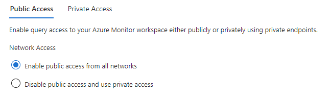

I have created an Azure Monitor workspace using a powershell script that is listed below. By default this creates this with public access enabled. How can I modify this script to disable this - i.e. select the disable public access button, using powershell ? User's image

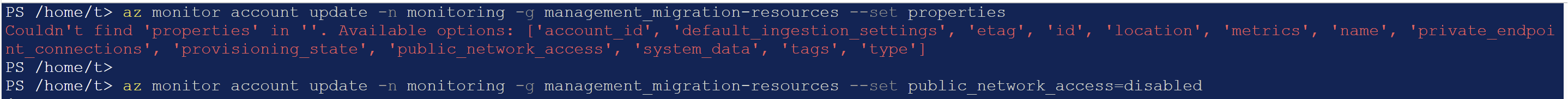

  2. tbgangav-MSFT 10,426 Reputation points Moderator
    2024-01-29T16:03:08.1866667+00:00
