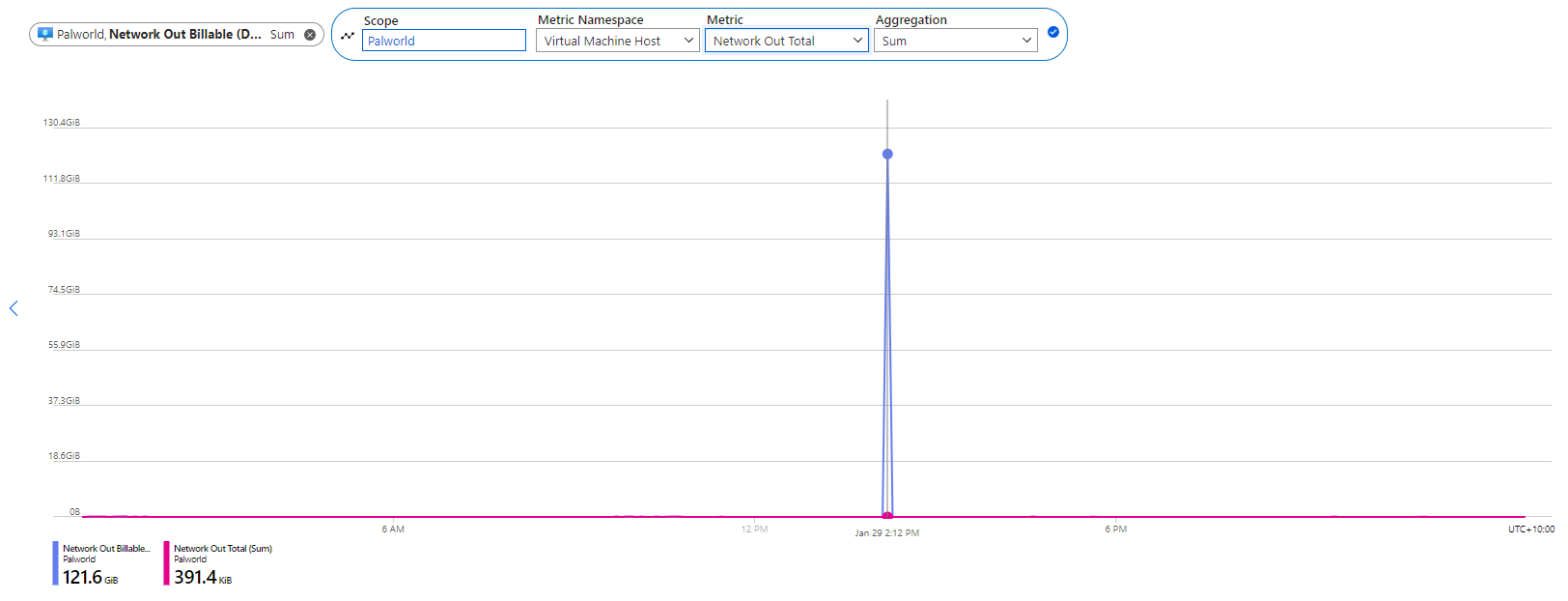

I was digging in metrics and noticed that "Network Out Billable(Deprecated)" and "Network Out Total" had difference by an order of magnitude of over a quarter of a million times. 120GiB vs  390Kib
Also, Network Out Billable (Deprecated) seems to match my bandwidth charges in billing.
What is Network In/Out Billable (Deprecated)? Why is it (Deprecated)? And why does it seem to give me more precise than Network In/Out Total? (I Assume it is because of the billing charge reflecting that cost) See graph:User's image

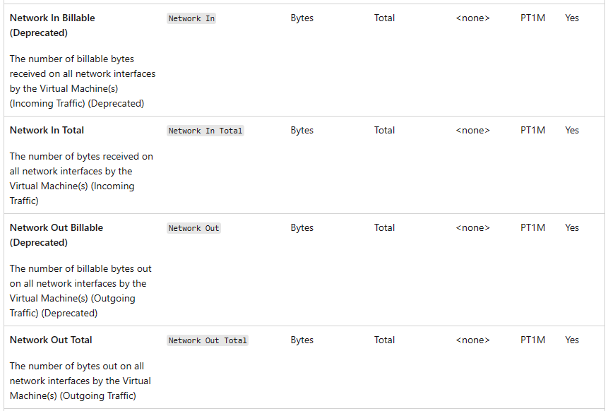

    Network Out Billable (Deprecated): The number of billable bytes out on all network interfaces by the Virtual Machine(s) (Outgoing Traffic) (Deprecated).
    Refer: https://learn.microsoft.com/en-us/azure/azure-monitor/reference/supported-metrics/microsoft-compute-virtualmachines-metrics
    It is deprecated as a new metric "Network Out Total" was created in its place with some additional improvements.
    I checked internally and found that there is an ongoing bug with the "Network In/Out Total" metric.
    In Accelerated Networking enabled VMs, some of the egress flow packets/bytes are not being counted in Network Out Total Metrics. When Accelerated Networking is enabled, VFP (Virtual Filtering Platform) is not incrementing outbound packets and bytes for the original port in VM that originated the packets, and this is why you see very less usage in the "Network Out Total" metric.
    If you are using an Azure VM with Accelerated Networking enabled, then your VM metric "Network Out Total" is affected by the above bug.
    The Product Group team is actively working on the issue. A fix is being developed for all VFP (Virtual Filtering Platform) versions to ensure that the egress flow packets/bytes are counted in Network Out Total Metrics. We don't have an ETA to share yet, but the fix should be deployed soon.
