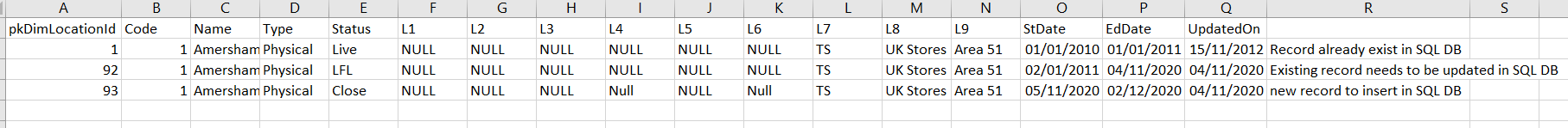

Not sure how do i proceed here . So I want to right sql query which inserts new record
If you see in the screenshot the second row is update which i can do it. No issues at all.
Regarding the third line which is insert into an existing table i am not sure how to do it.
The issue is pkdimlocationid is identity column and rest of the values are duplicate values.
So i need help in inserting record which starts with pkdimlocationid=93.
I did start the SQL code (but i lost track)which is

    This is just a sample. I have about 700 records in the data in dimlocation which i have to update.
    Inorder to make sure I am preparing my sql statement correct,I am taking the two sample into a temp table and then preparing my insert statement to make sure that it is correct before running the actual insert statement for all records.
    The issue is if you can see in the screenshot , I have pkdimlocationid which is an identity column and apart from that none of the columns are unique which i can use to insert the record.
    The first two records are you see in the screenshot is already present in the database. I need to insert the third one.

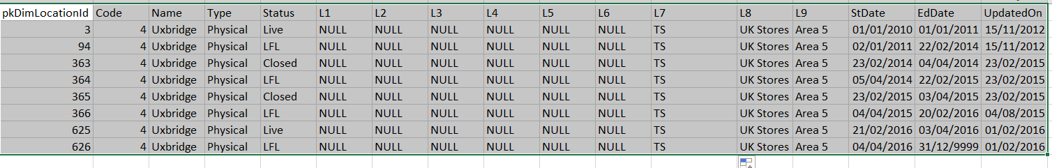

    here is another screenshot . This is what i am trying to achieve. So i have to create a script to update 700 records something in this manner.
    Henceforth I started taking all this into a temp table and then updating the record.
