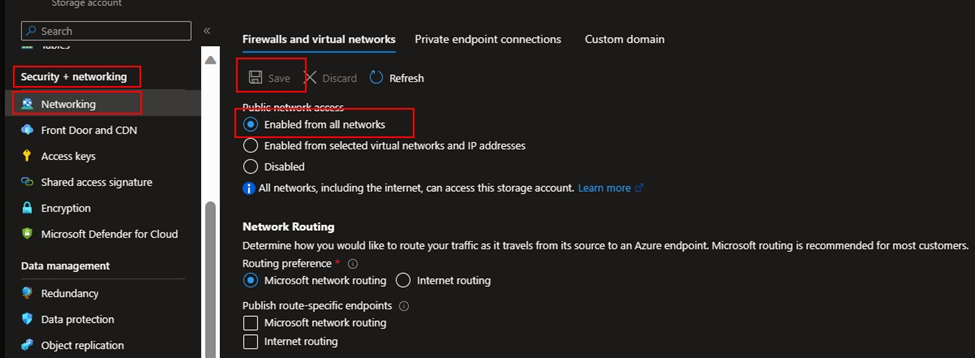

    Or else to resolve this, try below steps:
    Enable firewall to all networks or whitelist your IP if you are giving permission to selected IP's.

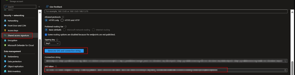

    User's image Generate SAS token with appropriate permission and use it in ADF (try with changing key 1 to key 2 and the generate).
