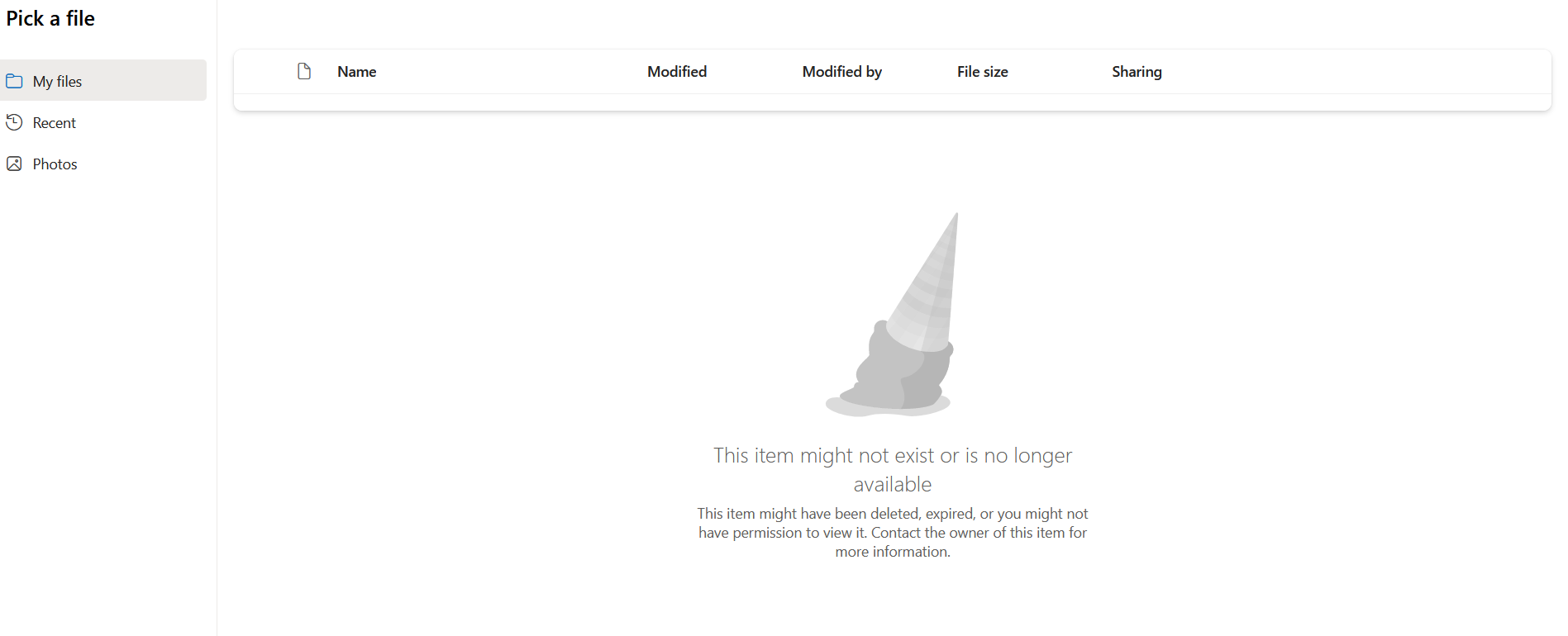

i am trying to connect OneDrive for my client on website where they can use their OneDrive to select files to upload.

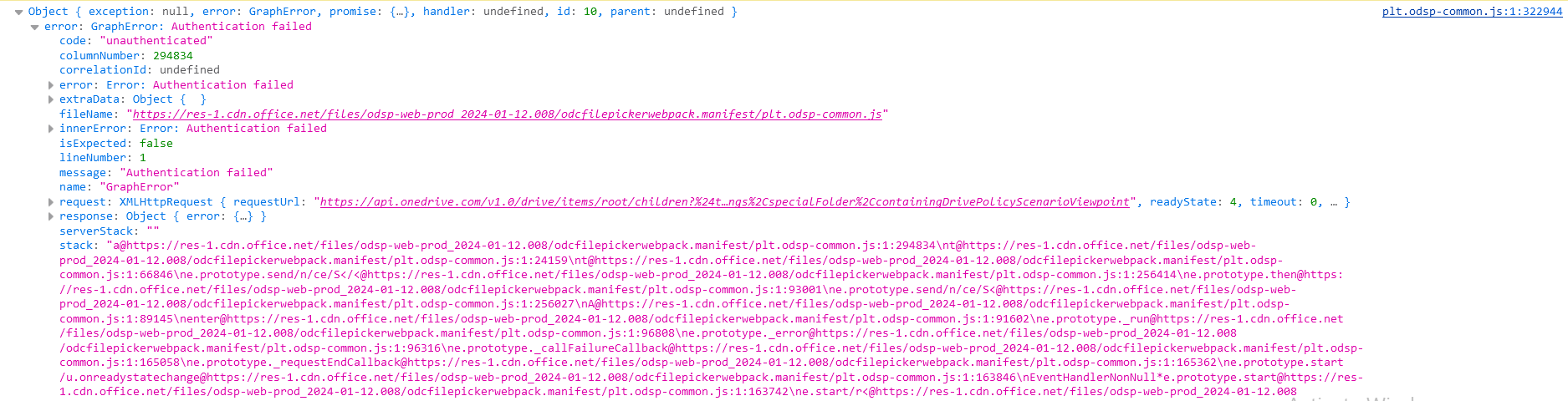

oneDrive file picker connected successfully but showing empty picker like this User's image
when i check console there are some errors showing
Error: Resource #285 "provider.instrumentation" is being consumed, but is not available in the current scope.
  1) Check to ensure that the dependency on this resource (and each step up the chain) is properly declared.
  2) If availability is expected, check to see if the target resource has a dependency that is only available in a child scope. Consumed directly.
