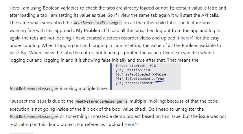

Here I am using Boolean variables to check the tabs are already loaded or not. Its default value is false and after loading a tab I am setting its value as true. So If I view the same tab again it will start the API calls. The same way I subscribed the WeakReferenceMessenger on all the other child tabs. The feature was working fine with this approach. My Problem: If I load all the tabs, then log out from the app and log in again the tabs are not loading. I have created a screen recorder video and upload it here for the easy understanding. When I logging out and logging in I am resetting the value of all the Boolean variable to false. But When I view the tabs the data is not loading. I printed the value of Boolean variable when I logging out and logging in and it is showing false initially and true after that. That means the WeakReferenceMessenger invoking multiple times. User's image
I suspect the issue is due to the WeakReferenceMessenger's multiple invoking; because of that the code execution is not going inside of the if block of the bool value check. Do I need to unregister the WeakReferenceMessenger or something? I created a demo project based on this issue, but the issue was not replicating on this demo project. For reference, I upload Here

Do you want to register this message, then execute code only once in the Register event when Tabbedpage showing?
If so, you need to unregister the WeakReferenceMessenger with WeakReferenceMessenger.Default.Unregister<HomeTabChangeMessage>(this);. If unregister method is not working. Please try to use following code. It works normally in my side.
if(!WeakReferenceMessenger.Default.IsRegistered<HomeTabChangeMessage>(this))
    WeakReferenceMessenger.Default.Register<HomeTabChangeMessage>(this, (r, m) =>
        MainThread.BeginInvokeOnMainThread(async () =>
            if (m.Value == "Tab1")
                Debug.WriteLine("1=isTab1Loaded:>>" + Utility.isTab1Loaded);
                if (!Utility.isTab1Loaded)
                    Utility.isTab1Loaded = true;
                    Debug.WriteLine("***Tab1Loaded***");
