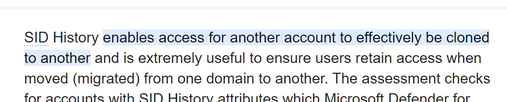

Hi, We are using ADMT tool for the user migration. and we have selected the option migrate Users SIDs to target also so that after migration users can access all the share file and folders of the source domain. just to validate the below attached image statement. But after the successful migration when users want to access the file/ folders, unable to access and getting permission error. User's image
