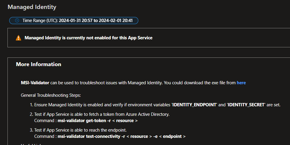

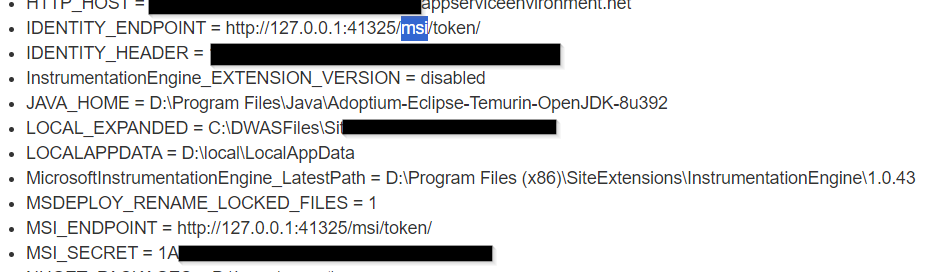

We have a function app in our dev environment that isn't able to connect to our sql database using managed identity. I used the msi-validator.exe utility from within kudu of the function app production slot to test connectivity with the database and it failed with "Unable to connect to SQL. Exception : Login failed for user '

    Hi @Rafe Kemmis - Were you expecting the app deployed to the dev slot to access the same SQL DB that the production slot already has access to? or apps in both dev and prod slots aren't able to access the DB with either of its managed identities? Deployment slots are separate, live apps with their own hostnames so System Assigned identity would be unique to each slot.

    @Rafe Kemmis can you please switch off and on again the managed identity and see if the behaviour is persistent ?
