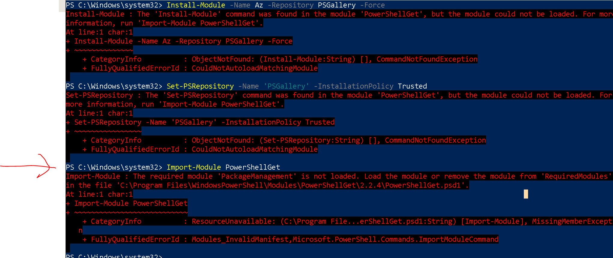

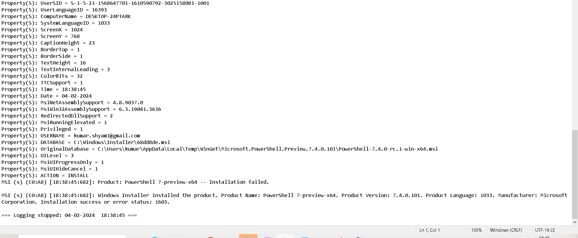

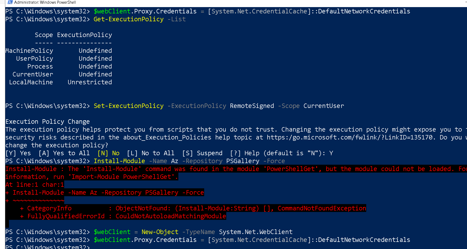

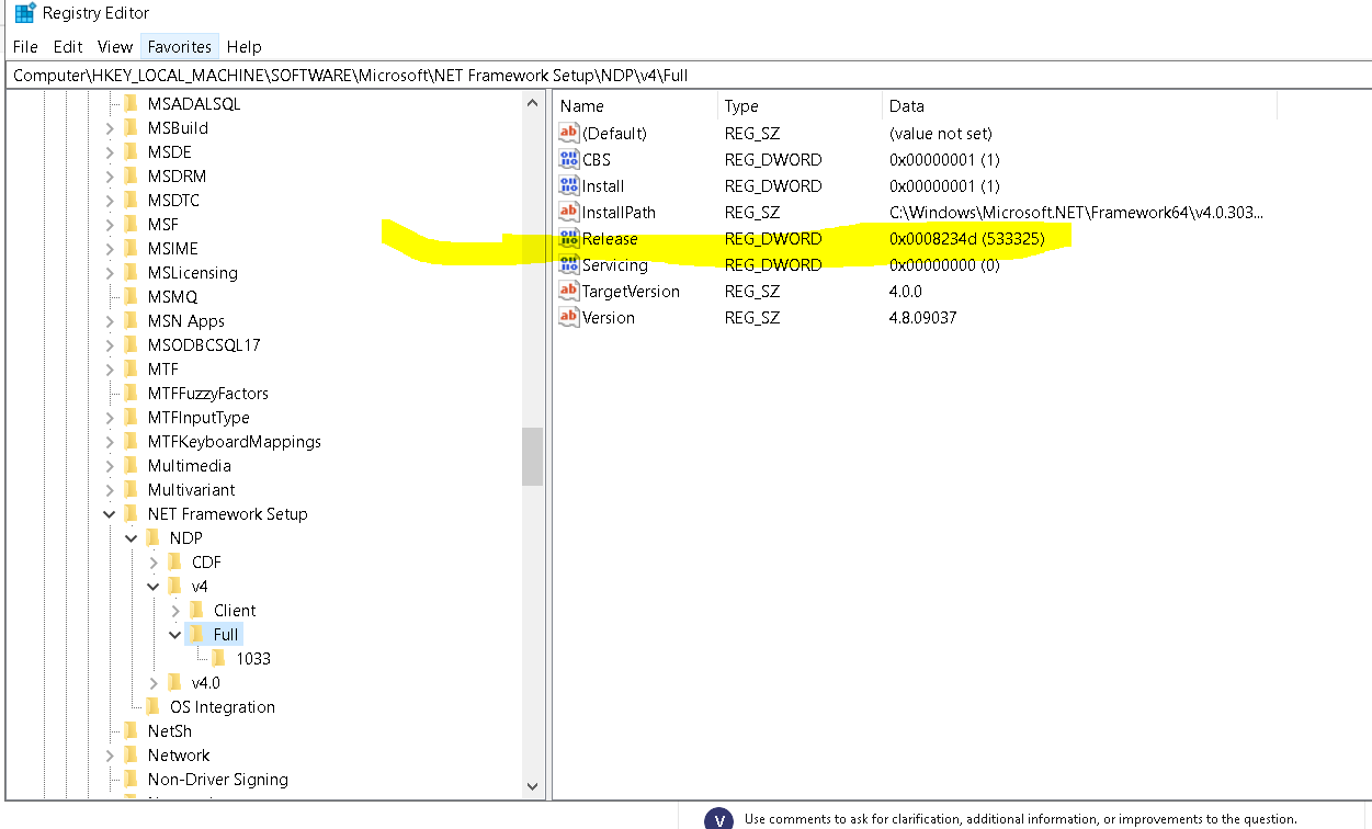

I am trying to connect to Azure PowerSHell, but I am getting following errors I tried following steps: User's image
and User's image
and it seems i need to load .psd1 based onn above error Please suggest what exactly needs to be done.

  1. JimmySalian-2011 42,511 Reputation points
    2024-02-03T16:12:12.7333333+00:00
    Try running the commands via the Admin mode and always follow that process, check the steps here and it should be good - https://learn.microsoft.com/en-us/powershell/azure/install-azps-windows?view=azps-11.2.0&tabs=powershell&pivots=windows-psgallery
    Hope this helps. JS

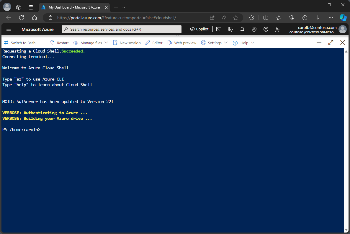

    How do I install Azure PowerShell on Windows? What are alternatives to a local installation?
    I quickly want to mention an alternative to a local installation that I find to be very helpful, Azure Cloud Shell. It works from any browser, has up to date modules, and can be a quick and easy way to bypass any issues you may have with a local installation:
    https://learn.microsoft.com/en-us/azure/cloud-shell/get-started/classic?tabs=azurecli
    Screenshot of the new Cloud Shell user experience.
    If you are installing locally, I second the recommendation from @JimmySalian-2011 and would like to underscore that it is recommended to be used with PowerShell version 7 or higher:
    If you want to use PowerShell version 5.1, you'll need to meet these prerequisites:
    • Confirm your version of PowerShell with $PSVersionTable.PSVersion (and I see you have 5.1)
    • Determine if you have the AzureRM PowerShell module installed with Get-Module -Name AzureRM -ListAvailable (if you have the AzureRM PowerShell module installed, you'll need to reference Az and AzureRM coexistence).
    Then you'll need to complete the remaining perquisites:
    Update to Windows PowerShell 5.1 Install .NET Framework 4.7.2 or later
    • Update PowerShellGet Launch Windows PowerShell 5.1 elevated as an administrator and run the following command to update PowerShellGet:
      Install-Module -Name PowerShellGet -Force
    • Set the PowerShell execution policy to remote signed or less restrictive
      • Check the PowerShell execution policy:
        Get-ExecutionPolicy -List
    • Set the PowerShell execution policy to remote signed:
        Set-ExecutionPolicy -ExecutionPolicy RemoteSigned -Scope CurrentUser
    After the prerequisites have been completed, you can use the Install-Module cmdlet to install the Az PowerShell module:
    Install-Module -Name Az -Repository PSGallery -Force
