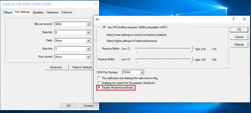

    Dear friend, have you found the solution or workaround? I had the same issue with CH340 chip. I was planning to use RTS# line to reset my MCU. The problem was that after PC reboot or USB replug COM settings resets to defaults with RTS# & DTR# enabled. Then I have undesired pulse at first port opening with CreateFile() until DCB init with SetCommState(). With WCH VCP driver I have option DisableModemHandShake (see picture). With this option checked, the problem was solved, RTS# & DTR# lines not asserts, even after USB replug, DCB reading gives fRtsControl, fDtrControl = 0. However, I still can use these signals with EscapeCommFunction() method. FTDI VCP driver gives similar option (disable modem signals at startup), but unfortunately it doesn't work same way :( Did you solve the problem with FT232 chip?CH340_Modem_off
