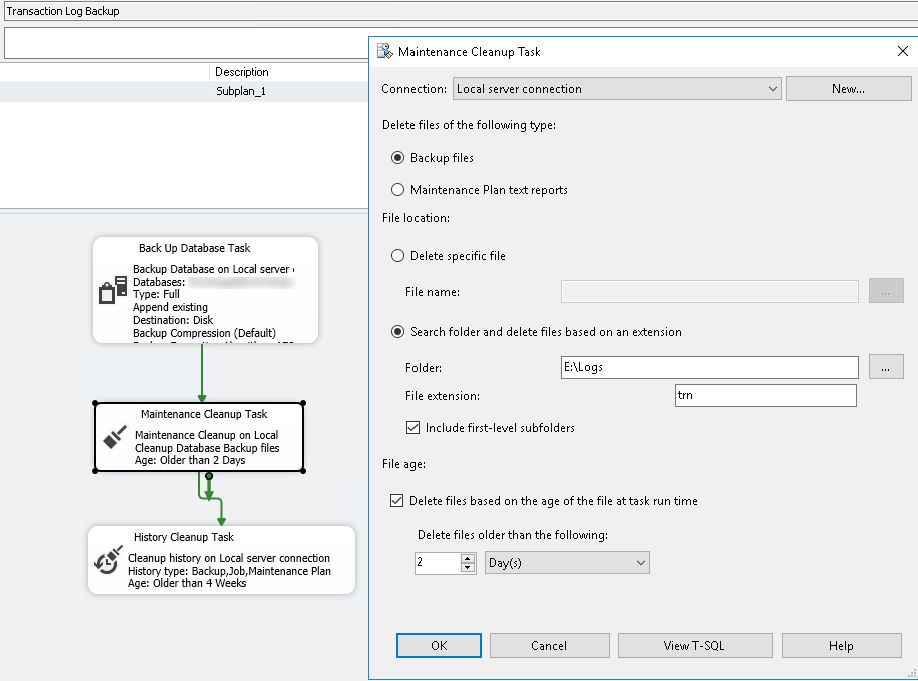

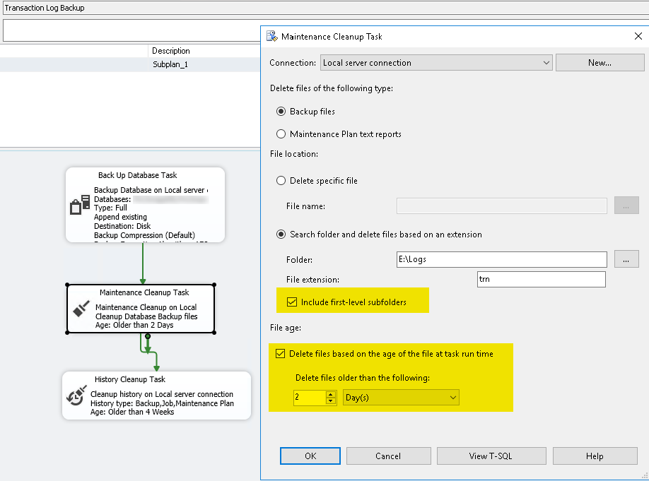

    In addition, The Maintenance Cleanup task does not automatically delete files in the subfolders of the specified directory. This feature reduces the possibility of a malicious attack that uses the Maintenance Cleanup task to delete files. If you want to delete files in first-level subfolders, you must select Include first-level subfolders.
    Check Maintenance Cleanup Task (Maintenance Plan)
