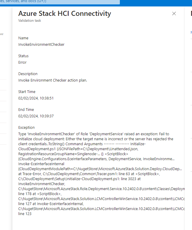

I have attempted to perform the Single Node AzsHci cluster deployment using 23H2. I have completed the prerequisite steps as presented in the Microsoft document and registered the host in Azure as well. While creating the cluster from the Azure portal, in the validation steps I'm getting the below error message from the Environment checker validation. Can you please guide me on this? Is this related to Active Directory credentials? image

    Based on the details shared, the error message shows that the Local administrator credentials entered in the Portal is not valid to access the cluster node. Please check if this local user is created on that node. Please also ensure the Domain Account entered in the Portal is also valid. If both are valid and matching with the AD user and Local user on the node then you should not see this error.
