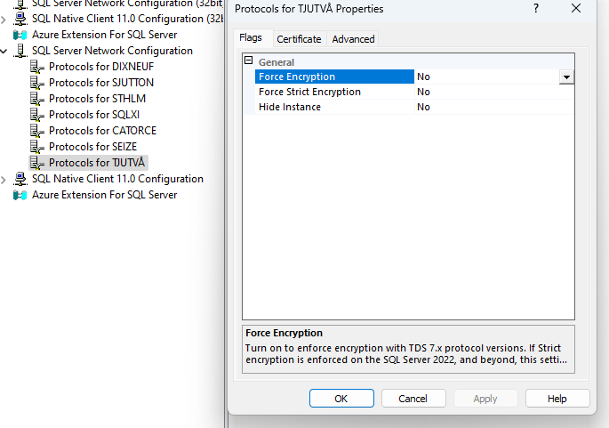

I am currently experiencing an issue connecting to my SQL server via SMSS installed on a Windows 11 machine. I am able to both ping the IP and hostname of the SQL server and telnet to the machine on 1433. I have verified that TCP is enabled in the SQL server configuration. However when attempting to connect with SQL Studio receive the following error:
TITLE: Connect to Server
Cannot connect to <HOSTNAME>.
ADDITIONAL INFORMATION:
A connection was successfully established with the server, but then an error occurred during the pre-login handshake. (provider: SSL Provider, error: 0 - The wait operation timed out.) (Microsoft SQL Server, Error: 258)
For help, click: https://docs.microsoft.com/sql/relational-databases/errors-events/mssqlserver-258-database-engine-error
BUTTONS:
OK
I have verified that locally on the SQL Server I am able to connect with SMSS without issue. I have attempted increasing the timeout for the connection and this did not help resolve the issue. This occurs if I am using Windows Auth or SQL Auth
