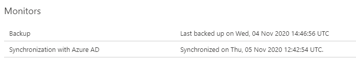

I've got an issue getting users logged on in AAD DS which are synced from AD on premise -> AAD -> AADS.
I have AD connect setup and added the items and ran the script here: https://learn.microsoft.com/en-gb/azure/active-directory-domain-services/tutorial-configure-password-hash-sync and left it for a few days to sync but unfortunately it's not worked, I can't login to AAD DS with any account that originated in the on premise AD
I have followed all the troubleshooting steps I could find but have not been able to find a solution.
The On Prem DC has an up to date version of AD Connect and the script seem to go through fine and has been left for a few days.
Checking the connector I can see that in the global parameters Force Full password sync is in there:
GlobalParameters : {Connector.GroupFilteringGroupDn : , Connector.DeviceContainerDn : CN=RegisteredDevices,DC=[REDACTED], Microsoft.Synchronize.ForceFullPasswordSync
ADDS from the Azure portal looks like it's syncing correctly.
I'm pretty stuck so any help is appreciated, Is there anyway I can check visibly if the Hashes have hit AAD and AADS?
