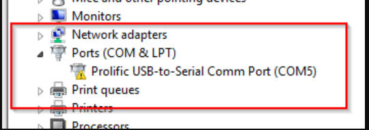

    Thanks for your post. Can I know have you loctated to the Device Manager-Ports and see any warning information below, such as the following yellow triangle. If there is a yellow triangle next to "Prolific USB-to-Serial Comm Port (COM X)". That means correct driver version is not installed. Kindly narrow down if it is related to driver firstly. User's image
