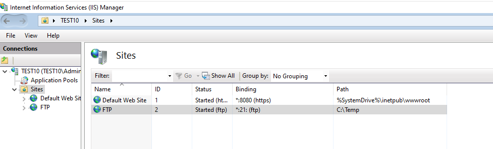

    The features view should look like this. The sites should have different ID's.
