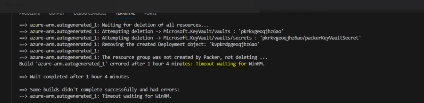

Issue description:
When we run packer buid in the backend VM creates during this process we are seeing winrm time out issue
Error:
==> azure-arm.autogenerated_1: Removing the created Deployment object: 'kvpkrdpvdfu0h9tfg'
==> azure-arm.autogenerated_1: The resource group was not created by Packer, not deleting ...
Build 'azure-arm.autogenerated_1' errored after 8 minutes 40 seconds: Timeout waiting for WinRM.
==> Wait completed after 8 minutes 40 seconds
==> Some builds didn't complete successfully and had errors:
--> azure-arm.autogenerated_1: Timeout waiting for WinRM.
==> Builds finished but no artifacts were created.User's image
