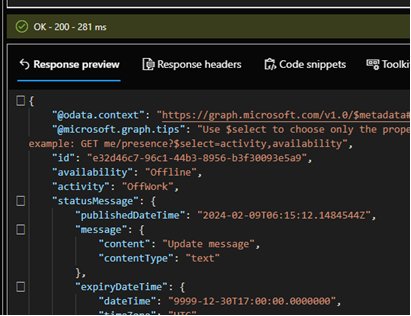

  • When my status is "out of office - away," I receive the following response from the get presence endpoint: User's image
  • When my status is "out of office - offline," I receive the following response from the get presence endpoint: User's image

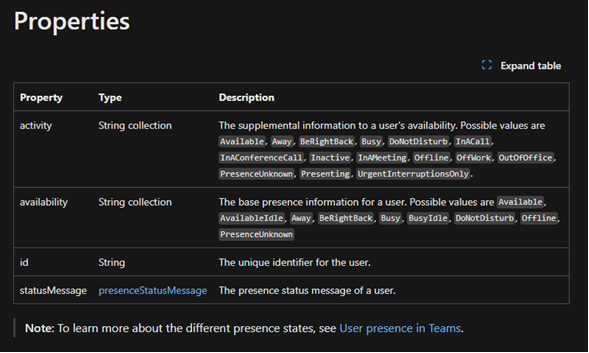

I believe the response should indicate "out of office" in these scenarios - based on the possible values on the documentation: User's image

    I have tried to replicate this issue and I was able to see similar behavior with this Graph API.
    I would recommend you to raise a support case with Microsoft Graph, a Support Engineer will be able to assist you better. You can raise support ticket from New support request - Microsoft Entra admin center or https://admin.microsoft.com/#/support/requests.

    You can now get the out of office message through the Graph Get presence beta endpoint.
    GET /me/presence
    GET /users/{id}/presence
    GET /communications/presences
    The beta endpoint response will have an outOfOfficeSettings property in it, that contains the out of office message. Or, you can get it via the mailboxSettings endpoint: https://learn.microsoft.com/en-us/graph/api/user-get-mailboxsettings?view=graph-rest-1.0&tabs=http Thanks,  Prasad Das
