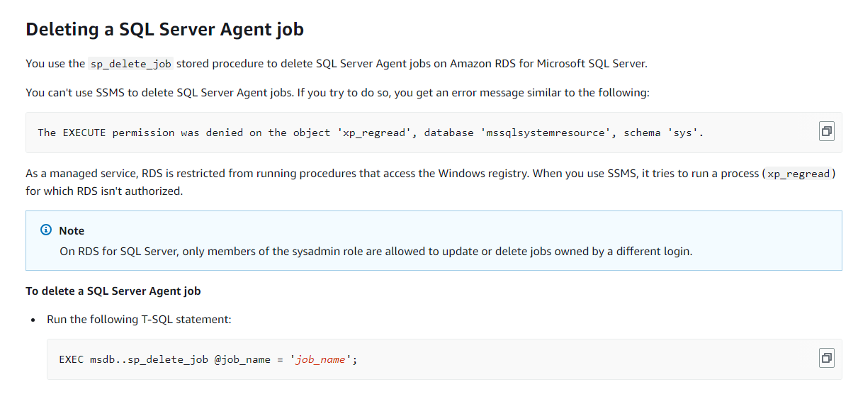

When trying to delete a job using SSMS v19.3 SQL Server Agent UI getting error: The EXECUTE permission was denied on the object 'xp_regread', database 'mssqlsystemresource', schema 'sys'. (Microsoft SQL Server, Error: 229) According to this RDS documentation only this command needs to be run in order to delete the job successfully: EXEC msdb..sp_delete_job @job_name = 'my job'; SSMS needs to identify it's an RDS instance and only run it.

    The link you post explicitly says;
    You can't use SSMS to delete SQL Server Agent jobs. If you try to do so, you get an error message similar to the following:> The EXECUTE permission was denied on the object 'xp_regread', database 'mssqlsystemresource', schema 'sys'.
    That is, you need to run sp_delete_job as described in the RDS documentation.
    Or are you asking for a feature request to SSMS? You can submit those here: https://feedback.azure.com/d365community/forum/04fe6ee0-3b25-ec11-b6e6-000d3a4f0da0

  3. ZoeHui-MSFT 41,491 Reputation points
    2024-02-15T02:40:43.2733333+00:00
    Hi @Yoni Sade, As the docs said, the error should occur, what's your concern? User's image Regards, Zoe Hui
