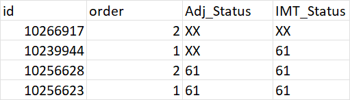

HI Team how do i update the status values by comparing the two columns in the below here the status is Adj_Status and IMT_Status values are different then i need to update the IMT_Status from Adj_Status Please let us know ur inputs ,here these status are coming from two different tables(Adj_Status & IMT_Status),we can compare these status from two different tables and update the IMT_Status from adj_status User's image

    Erland is right, this would be much easier to answer if you could provide the two tables structures separately (and as code instead of as an image). I've assumed that you mean this:

    If that's correct, you can update #imt from #adj like this:
    UPDATE tgt
    SET IMT_Status = src.Adj_Status
    FROM #adj src
      INNER JOIN #imt tgt ON tgt.id = src.id
