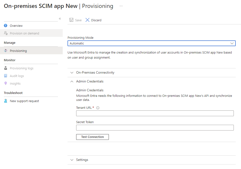

I have multiple issues with both an existing On-premises SCIM app and with a newly created one as well.
  1. With the existing one that I have working in the past:
    I have multiple agents across different systems I have used with this app in the past, and I always pick and choose the one that I want to use. When I want to select a new agent on a running vm that I have setup and press Assign Agent(s) I get an error saying We encountered and error while updating agent(s) of On-premises SCIM app. I have found a workaround this error by selecting all the agents, assigning and then selecting the one I want. However, when I do this and I try and Test Connection using the Admin Credentials I get back an InternalServerError however I see no errors in my event logs.
  2. I have tried working around this issue by creating a branch new On-premises SCIM app:
    There when I try and test connection my agent seems to be hit and I see an error about failing to convert a json object to a user model. I would assume this would be due to mapping but I don't see the Mappings section that is available in my existing app.
When I click on More events in the activity log there's nothing there.
Edit: I'm following these steps:
https://learn.microsoft.com/en-us/entra/identity/app-provisioning/on-premises-scim-provisioning#install-and-configure-the-microsoft-entra-connect-provisioning-agent Thanks

    Mappings option would be visible only when you pass the test connection with the app. The Microsoft Entra provisioning service generally makes a get-user call to check for a dummy user - https://learn.microsoft.com/en-us/entra/identity/app-provisioning/use-scim-to-provision-users-and-groups#request-3 in three situations: at the beginning of each provisioning cycle, before performing on-demand provisioning and when test connection is selected. This check ensures the target endpoint is available and returning SCIM-compliant responses to the Microsoft Entra provisioning service.
