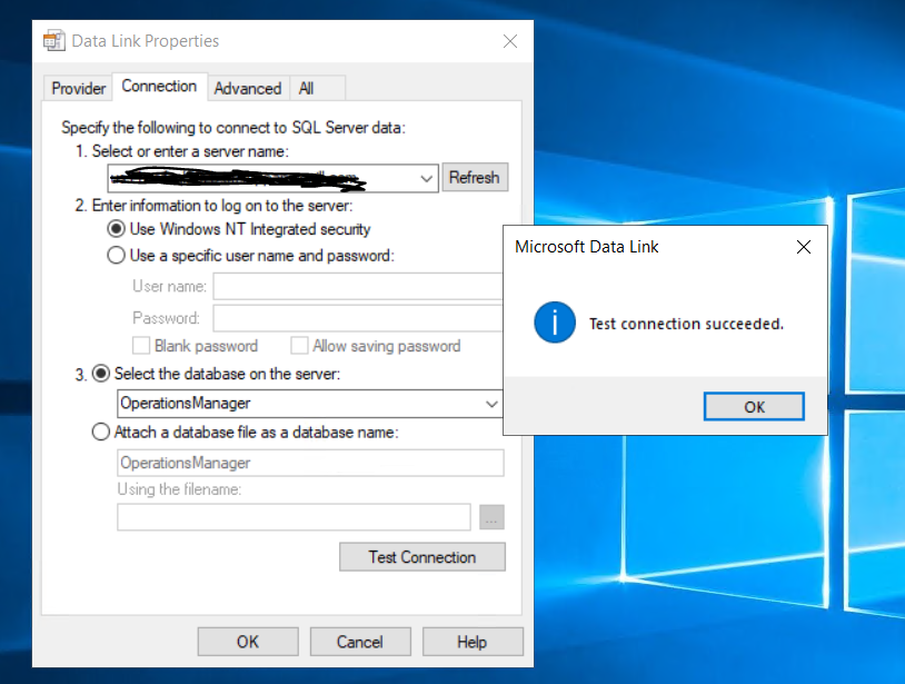

  1. XinGuo-MSFT 22,231 Reputation points
    2024-02-14T07:51:45.7233333+00:00
    System.Data.SqlClient.SqlException (0x80131904): Execution Timeout Expired.  ........System.ComponentModel.Win32Exception (0x80004005): The wait operation timed out
    I would say there are issues with the DB. Can you verify the DB connection works fine.
    Perform a UDL test to check the SQL Server Connectivity.
    • Create a new text file (e.g., sqlconn.txt), and then rename the extension from .txt to .udl.
    • Test the connection using the SQL Server OLE DB provider
    Screenshot of OLE DB Data Link Pages - Connection Tab
