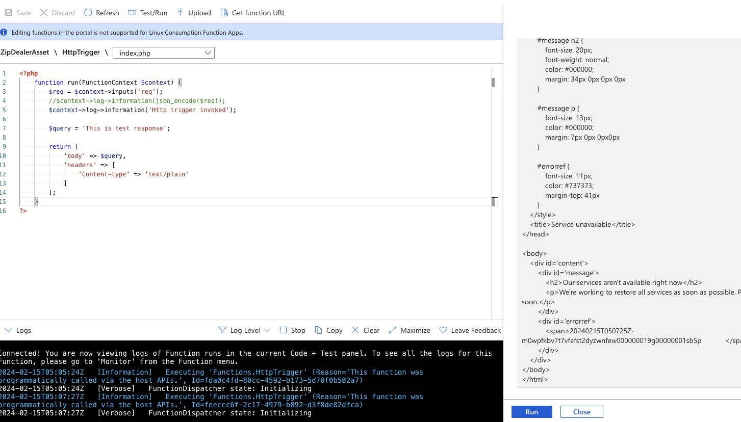

Facing following issues at the moment after publishing func azure functionapp publish $functionName:
  1. Using Test/Run in browser function is returning 504 Gateway timeout with "GET" request
  2. Message is "Our services aren't available right now"

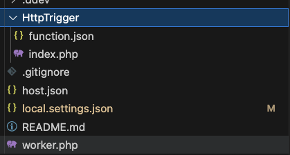

Following is the structure of code:
Screenshot 2024-02-14 at 4.45.19 PM

    In your index.php file I have changed the below to make it simple and I have tested the same after modifying the above and below changes.
    <?php
        function run(FunctionContext $context) {
            $req = $context->inputs['req'];
            //$context->log->information(json_encode($req));
            $context->log->information('Http trigger invoked');
            $query = 'This is test response';
            return [
                'body' => $query,
                'headers' => [
                    'Content-type' => 'text/plain'
    Note: Your most of the error will be solved if you update the host.json with the right value and make sure to run your visual studio code in administrative mode. You also need to make sure that you have PHP installed and the environment path is correctly reflected to your path where your php folder exists and php folder\ext User's image User's image
