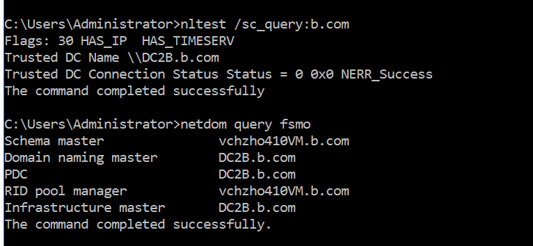

    Before you troubleshoot the SYSVOL replication issue, you need to make sure AD replication status is OK. And I can't run nltest on DC1, it throws ERROR_NO_SUCH_DOMAIN for the exact same command/domain as when I ran it on DC2 which is successful. A: Yes, I can run nltest /sc_query:domain.com on non-PDC successfully and receive ERROR_NO_SUCH_DOMAIN on PDC.
    Here is the result on PDC. User's image
    Here is the result on non-PDC.
    I hope the information above is helpful. If you have any questions or concerns, please feel free to let us know. Best Regards, Daisy Zhou
