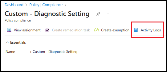

    To be able to add "diagnostic settings" for a resource, the identity should have "Monitoring Contributor" role. Or, as suggested by Timmy, you can further drill down to the specific permission based on the requirement as mentioned here -
    Monitor permissions and Azure custom roles.
    Furthermore, as mentioned here, to create or edit a diagnostic setting, users must also separately be granted ListKeys permission on the target resource (storage account or event hub namespace). Regarding your other question for a way to check errors related to DINE policy, please use the following:
    1. Azure portal --> Policy --> Compliance
    2. Search for the Initiative which was assigned and click on it.
    3. The next page takes you to the page which has information about resource compliance.
    4. Furthermore, you could also review the "Activity Logs" on this page to check for activities which were triggered. This should also contain information about failures, if any User's image
