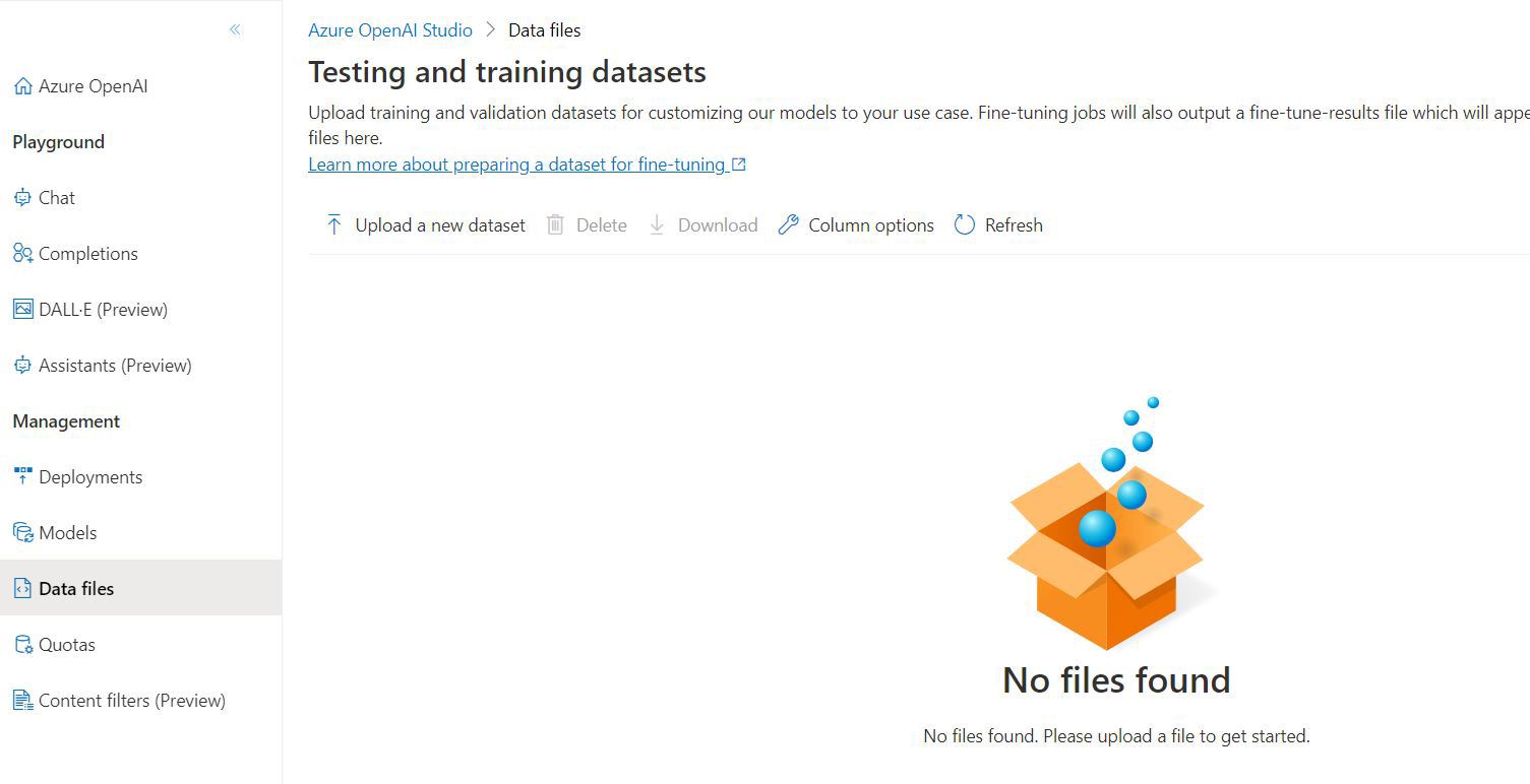

    Take care of the Prerequisites section of the Azure OpenAI GPT 3.5 Turbo fine-tuning tutorial and make sure you have prepared correctly. Specifically, note the model, service version, and resource region:
    gpt-35-turbo-0613 - fine-tuning of this model is limited to a subset of regions, and is not available in every region the base model is available.
    • Check if your resource region information is North Central US or Sweden Central
    • Check your deployment is GPT 3.5 Turbo version 0613?
    Screenshot that shows how to configure an Azure OpenAI resource in the Azure portal.
    You can read more details below.
