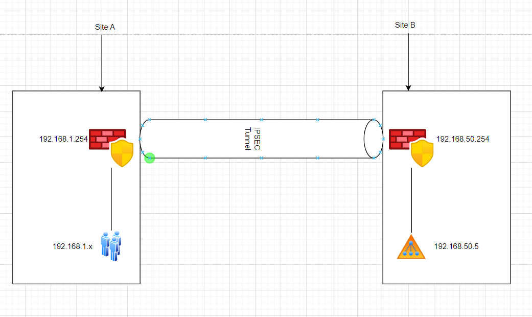

I have 2 sites connected using IPsec with a firewall between them. See the site A and B configuration information below: Site A: 1) local client that wants to join the domain from site B Active Directory ( 192.168.50.5). 2) Have 3rd party DNS configured on this subnet (192.168.1.x)
Site B: Domain controller installed and already configured. User's image
Question: When staff wanted to join the domain it showed an error as below
