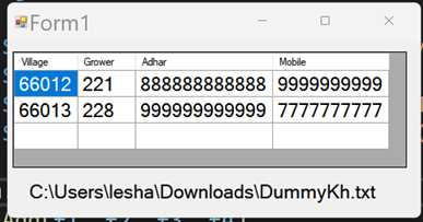

    Hi Here is another test piece of code to try. The changes are very minimal from the first version. This is only testing the Integer and Decimal aspects of the data - the overall loop limits is a separate issue and not changed in this version. (NOTE: the code input in the forum is completely broken and I can not be bothered to try and find a workaround) Option Strict On Option Explicit On Public Class Form1 Dim lines As New List(Of String) Dim linestoremove As New List(Of String) Dim dt As New DataTable("Freddy") Private Sub Form1_Load(sender As Object, e As EventArgs) Handles MyBase.Load With dt .Columns.Add("Village", GetType(String)) .Columns.Add("Grower", GetType(String)) .Columns.Add("Adhar", GetType(String)) .Columns.Add("Mobile", GetType(String)) End With DataGridView1.DataSource = dt lines = IO.File.ReadAllLines(LabelFile.Text).ToList For i As Integer = 0 To 10 ' NOT a valid idea !!!! Dim f1 As String = FindData("Village Code / Name(6/7)") Dim f2 As String = FindData("Grower Code / Name(8)") Dim f3 As String = FindData("Adhar Number(14)") Dim f4 As String = FindData("Mobile Number(13)") If f1.Trim.Length > 0 Then dt.Rows.Add(f1, f2, f3, f4) For Each line As String In linestoremove lines.Remove(line) Next End If Next End Sub Private Function FindData(s As String) As String Dim allowed() As Char = "1234567890.".ToCharArray Dim fld As String = String.Empty For Each line As String In lines Dim st As Integer = line.IndexOf(s) If st > -1 Then Dim num As String = String.Empty For i As Integer = st + s.Length To line.Length - 1 Dim ch As Char = line(i) If allowed.Contains(ch) Then num &= ch Else If IsNumeric(num) Then linestoremove.Add(line) Return num End If End If Next End If Next Return String.Empty End Function End Class

    Here is an alternative possibility. Please note: parsing a particular file is fraught with possible errors/problems/exceptions and any other fault you can think of. For example, breaking out of loops is so dependant on known factors - such as number of records and/or many other possibilities that errors are very possible. This is a stand alone example. It works with the test data file, but will likely fail with any dataset that is not EXACTLY the same format. Anyway, if you want to try my example, start a new project and add a DataGridView1 and a Label named LabelFile in the Designer. Copy/replace existing code with the code below. 111
    Option Strict On Option Explicit On Public Class Form1 Dim lines As New List(Of String) Dim linestoremove As New List(Of String) Dim dt As New DataTable("Freddy") Private Sub Form1_Load(sender As Object, e As EventArgs) Handles MyBase.Load With dt .Columns.Add("Village", GetType(String)) .Columns.Add("Grower", GetType(String)) .Columns.Add("Adhar", GetType(String)) .Columns.Add("Mobile", GetType(String)) End With DataGridView1.DataSource = dt lines = IO.File.ReadAllLines(LabelFile.Text).ToList For i As Integer = 0 To 10 ' NOT a valid idea !!!! Dim f1 As String = FindData("Village Code / Name(6/7)") Dim f2 As String = FindData("Grower Code / Name(8)") Dim f3 As String = FindData("Adhar Number(14)") Dim f4 As String = FindData("Mobile Number(13)") If f1.Trim.Length > 0 Then dt.Rows.Add(f1, f2, f3, f4) For Each line As String In linestoremove lines.Remove(line) Next End If Next End Sub Private Function FindData(s As String) As String Dim fld As String = String.Empty For Each line As String In lines Dim st As Integer = line.IndexOf(s) If st > -1 Then Dim num As String = String.Empty For i As Integer = st + s.Length To line.Length - 1 Dim ch As Char = line(i) If IsNumeric(ch) Then num &= ch Else If IsNumeric(num) Then linestoremove.Add(line) Return num End If End If Next End If Next Return String.Empty End Function End Class
