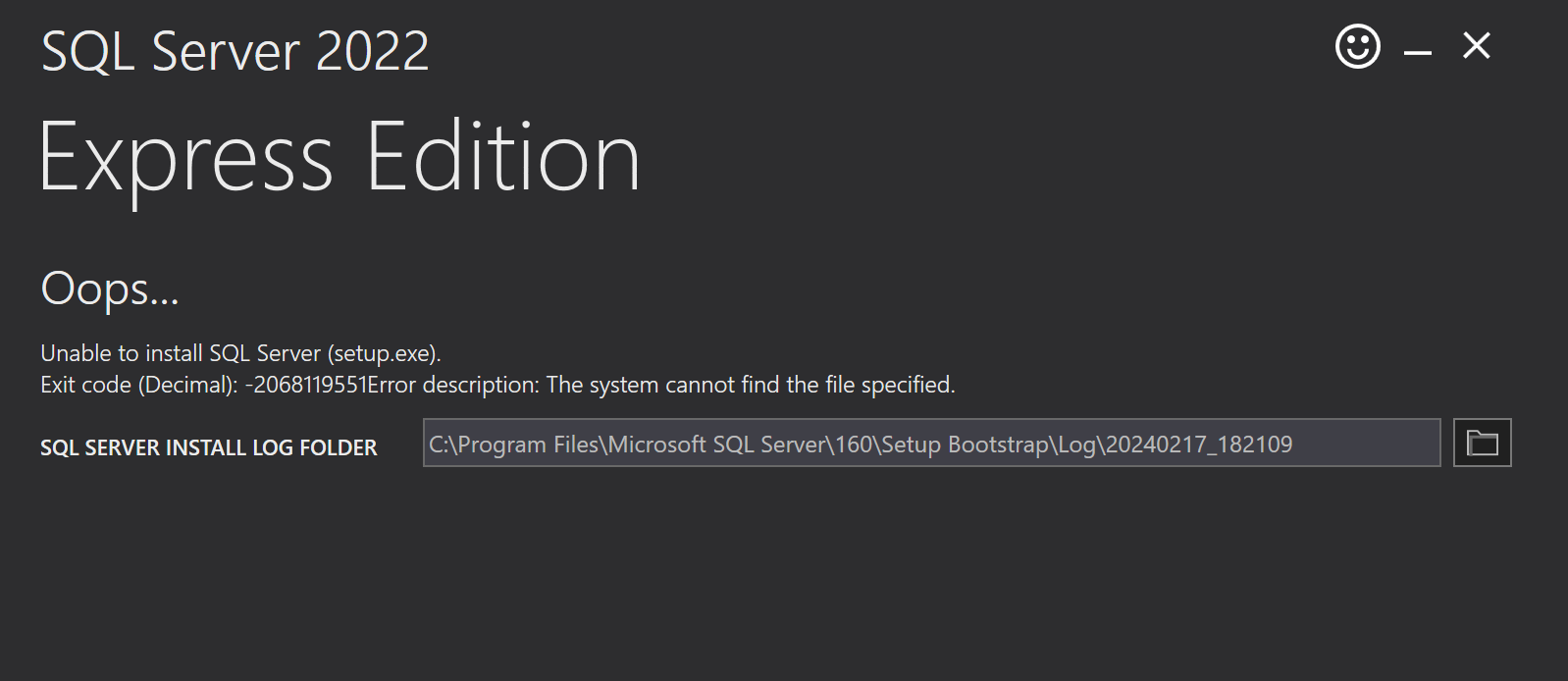

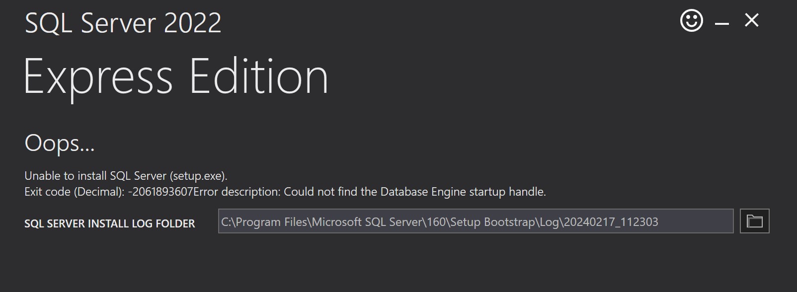

Hello there, I was trying to install SQL Server 2022 Express edition on my Windows 10 pro laptop, but in the end, the installation process kept getting stuck. I tried to restart the system, uninstall & reinstall the software, yet nothing changed, again the same error with the following screenshot:
Screenshot 2024-02-17 133903.jpg For convenience, I have attached an error file for you. I need to get this thing done as soon as possible for my boot camp project ERRORLOG.txt

    It seems that you've run into the situation that you have installed, cleaned up things at random, and now Setup is failing because it get confused by remnants. Or at least that is my impression from the error messages you get. I would suggest that you follow this article to uninstall everything you have now: https://www.sql-easy.com/learn/how-to-uninstall-sql-server/ I learnt about this article from another poster I tried to help. This poster eventually found this article on his own, and reported that after following the advice in the article, he was able to install SQL Server. Now, there is likely to be a reason why your first installation failed, and as long as you address that problem, installation will fail again. But hopefully then with the "right" error. The other alternative is to create a VM and install SQL Server on the VM.

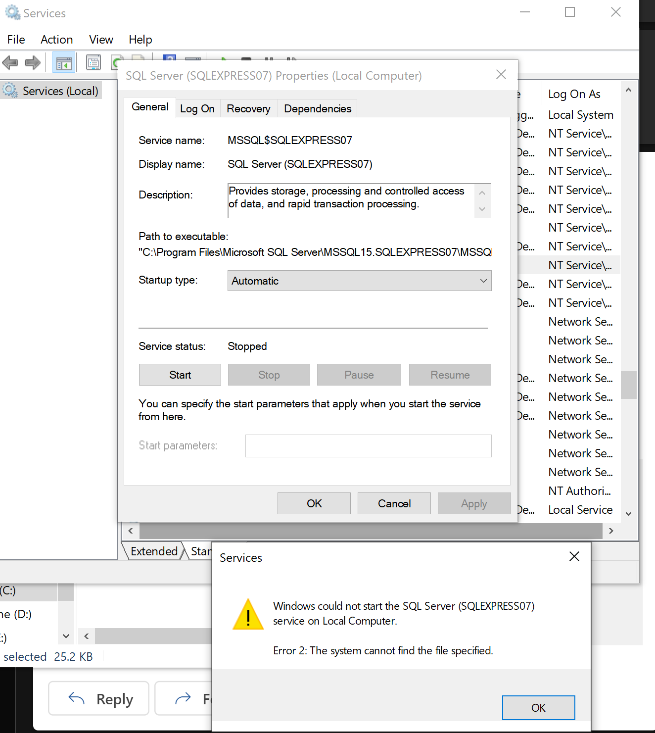

    Thanks for uploading the SQL Server errorlog, but unfortunately it seems that you got hold of the wrong one. The errorlog you attached is from an installation of SQL 2019, and that installation seem to have completed successfully, at least from what I can see in the errorlog file.
    I can see that instance name for your SQL 2019 instance is SQLEXPRESS07, which suggests that you have made a couple of attempts.
    The errorlog file for the attempt to install SQL 2022 should be in C:\Program Files\Microsoft SQL Server\MSSQL16.SQLEXPRESSnn\MSSQL\LOG\ERRORLOG.
    Then again if your instance SQLEXPRESS07 is up and running, can you use this for your boot camp? Or do you need SQL 2022?
