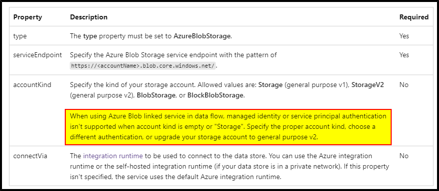

    It seems like you are encountering an error message while running a data flow in Azure Data Factory. The error message indicates that the storage with user assigned managed identity authentication as staging is not supported.
    When using Azure Blob linked service in data flow, managed identity or service principal authentication isn't supported when account kind is empty or "Storage". Specify the proper account kind, choose a different authentication, or upgrade your storage account to general purpose v2.
    To resolve this issue, you can use a different authentication to create an Azure Data Lake Storage Gen2 or Azure Blob Storage linked service, then use it as staging in mapping data flows.
