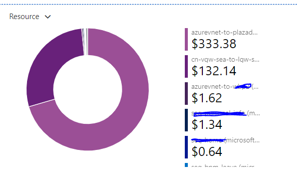

Hello, Today i check bandwidth cost for period Feb 2024 and i have some question such as :
  1. There are cost $333.38 for my VPN site to site, how we can know how much data in or data out so we can make calculation manually to compare the cost between manual calculation and cost on azure?
  2. There are cost $1.34 for my one of our web apps, how we can know how much data in or data out so we can make calculation manually to compare the cost between manual calculation and cost on azure?

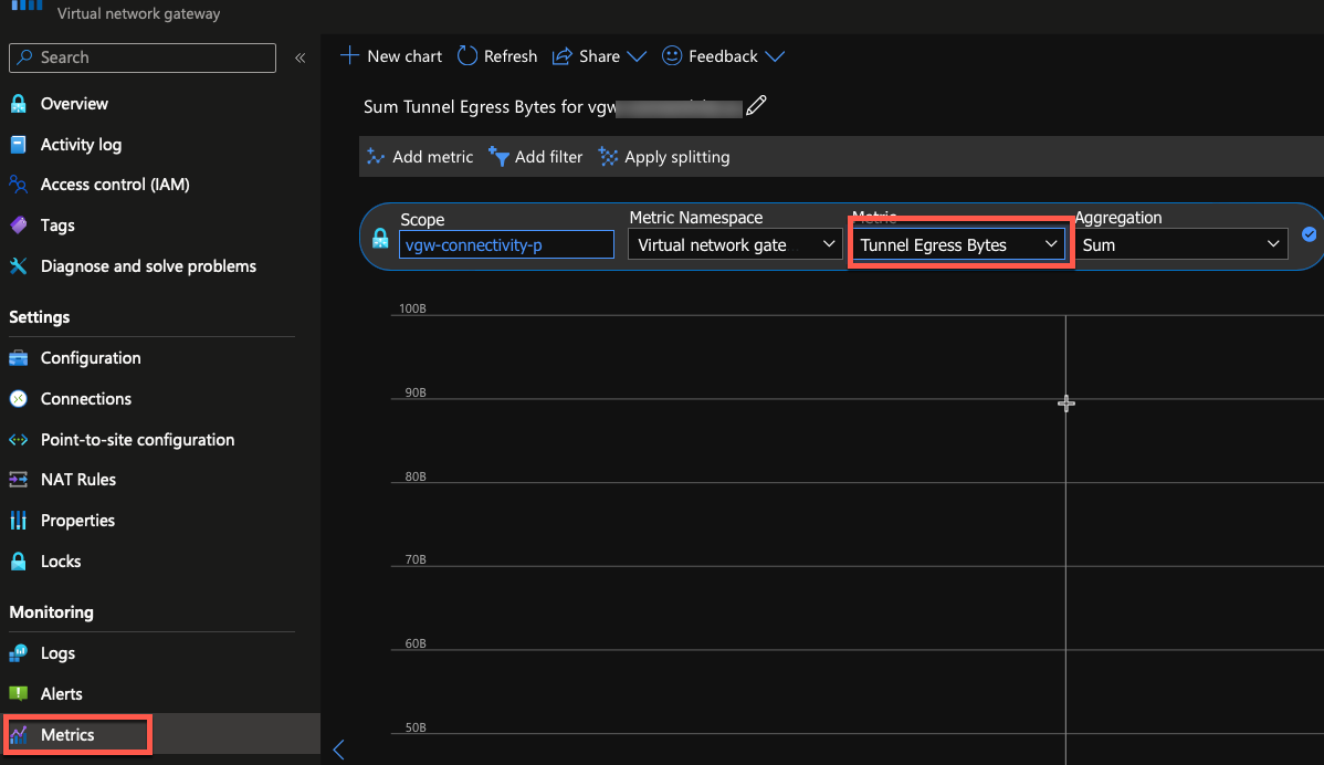

    Hi Handian, You can use the metrics to find the information you are looking for. In the picture below, you can see where to find them, and there are multiple metrics you can use to find the information. You can use the same method for app services. User's image
