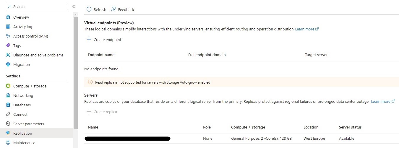

    In my original post I mentioned we had already successfully completed our migration from single to flexible server, so I won't go over the prerequisites for that.- In-place major version upgrade currently doesn't support read replicas, so if you have a read replica enabled server, you need to delete the replica before performing the upgrade on the primary server. After the upgrade, you can recreate the replica.
    1noreadonlyreplicas

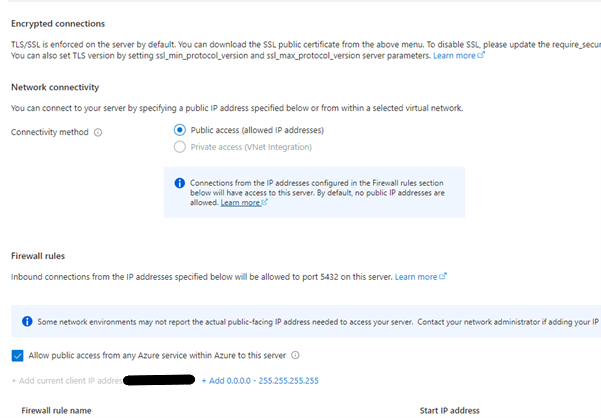

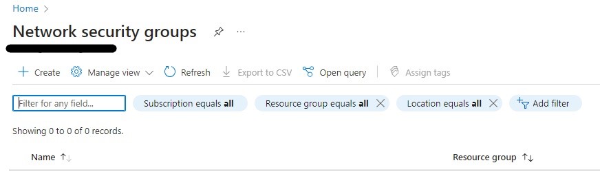

    We didn't have any read only replicas enabled, the server had storage auto growth enabled, which should be incompatible with this anyway.- *Azure Database for PostgreSQL - Flexible Server requires the ability to send and receive traffic to destination ports 5432, and 6432 within VNET where Flexible Server is deployed, as well as to Azure storage for log archival. If you configure Network Security Groups (NSG) to restrict traffic to or from your Flexible Server within its deployed subnet, please make sure to allow traffic to destination ports 5432 and 6432 within the subnet and to Azure storage by using service tag Azure Storage as a destination.If network rules are not set up properly HA is not enabled automatically post a major version upgrade and you should manually enable HA. Please modify your NSG rules to allow traffic for the destination ports and storage as requested above and enable a high availability feature on the server.
    2networkconfigurationfirewall
    3NSGs This is where things were a bit unclear to me. The server's firewall was configured to allow all traffic from any Azure service but we didn't have any NSGs configured. We tried to add an NSG but this didn't make any difference. Do you have to have them in order to upgrade?

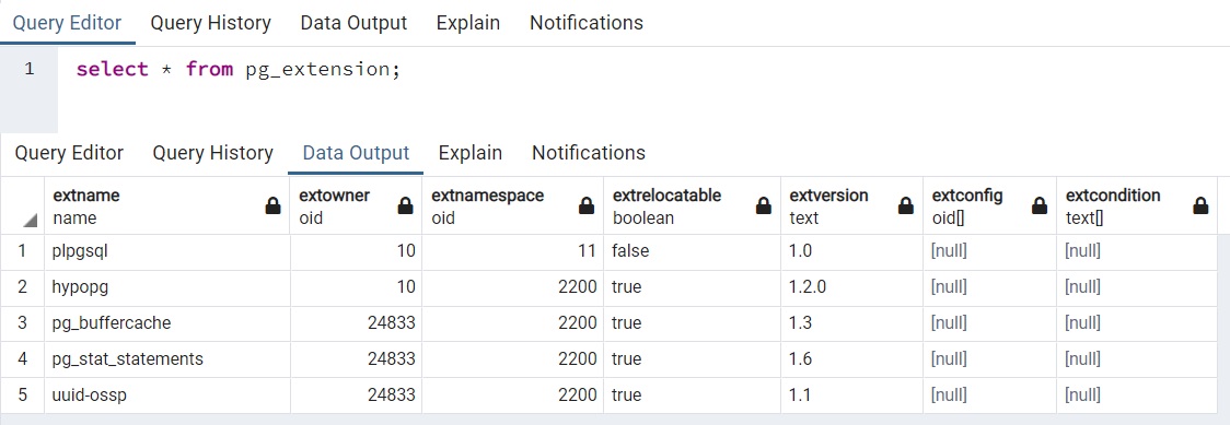

    • In-place major version upgrade doesn't support certain extensions and there are some limitations to upgrading certain extensions. The extensions Timescaledb, pgaudit, dblink, orafce, pg_partman, and postgres_fdw are unsupported for all PostgreSQL versions. 4gebruikteextensions None of the those extensions were used on the database server.
