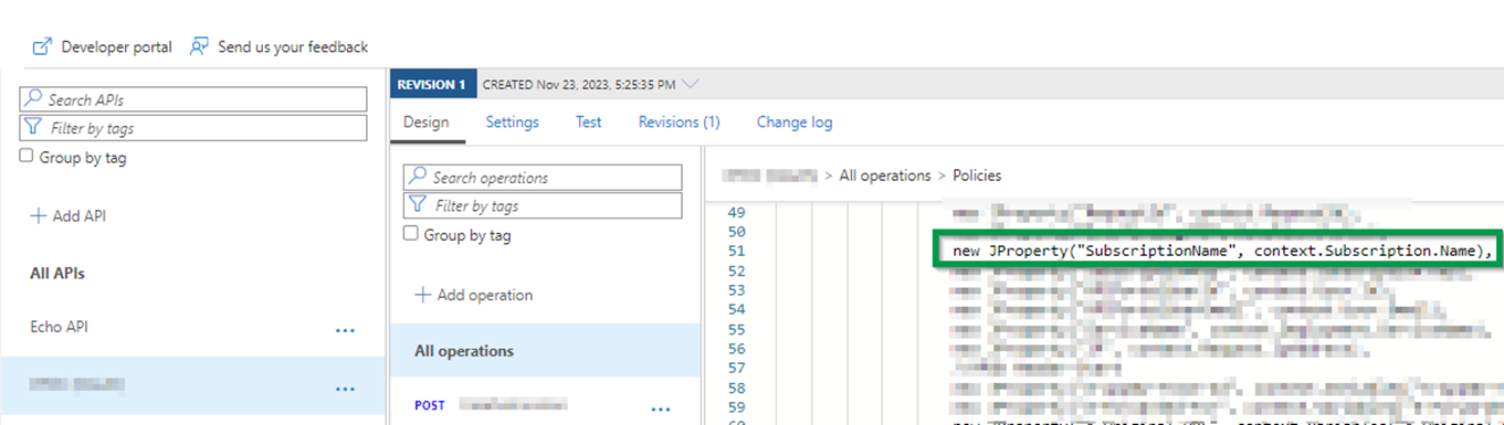

  1. Use following code snippet in the API policy
new JProperty("SubscriptionName", context.Subscription.Name), ==> Display Name is stored
new JProperty("SubscriptionId", context.Subscription.Id) ==> Nothing stored, it's blank.
But the Name fetched is Display Name, and if using SubscriptionId, it's blank. User's image

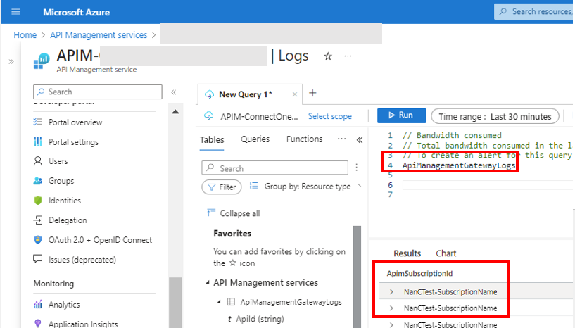

We hope to fetch the value like this, in the APIM > Logs .
(Though its field name here is ApimSubscriptionId)

    @Lily Thanks for reaching out. I see with context.Subscription.Id it retrieves name of the subscription and with context.Subscription.Name it retrieves display name of the subscription as shown below
      <inbound>
            <base />
            <set-variable name="subname" value="@(context.Subscription.Id)" />
            <set-variable name="subname" value="@(context.Subscription.Key)" />
            <set-variable name="subname" value="@(context.Subscription.Name)" />
        </inbound>
    set-variable (0.008 ms)
        "message": "Expression was successfully evaluated.",
        "expression": "context.Subscription.Id",
        "value": "thisisname"
    set-variable (0.012 ms)
        "message": "Context variable was successfully set.",
        "name": "subname",
    set-variable (0.003 ms)
        "expression": "context.Subscription.Key",
        "value": "7e59xxxxxxxxxxxx9bf794b"
    set-variable (0.002 ms)
        "name": "subname",
        "value": "7e5xxxxxxxxxxxf794b"
        "expression": "context.Subscription.Name",
        "value": "thisisdispalyname"
    set-variable (0.001 ms)
        "name": "subname",
    do check and let me know incase of further queries, I would be happy to assist you.
