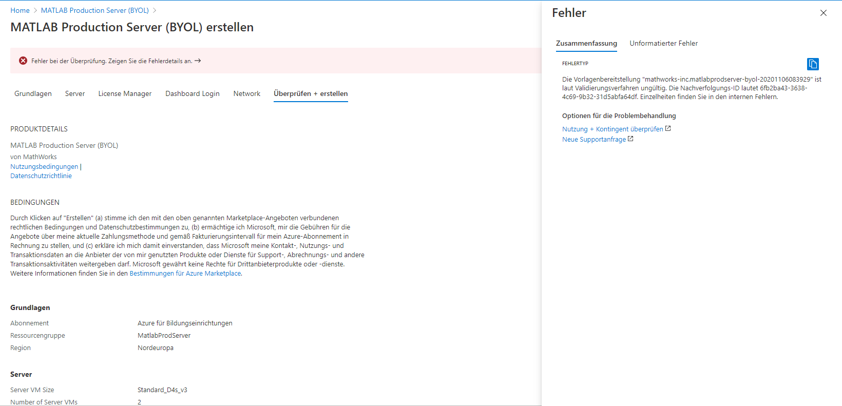

Hello, I try to create a Matlab Production Server like in this video: https://www.youtube.com/watch?v=9zSOgpfva-Q
I have a student accout on Azure and a student licence to Matlab Production Server with an accses to it.
The problem is, that the Azure shows an error bevor the acces to the create button.
What is the issue of that problem? Where can I past the problem ID 6fb2ba43-3638-4c69-9b32-31d5abfa64df to find it out?

    Hi @Anastasia Grigoreva ,
    While I don't speak German I believe the error message in the screenshot you provided refers to a deployment error. Please check:

    Thank you very much vor your suggestions. If I could change the language to english, I would show you the error message. I do not see the Language button on Azure.

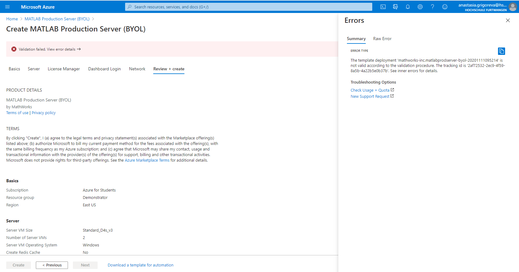

    I have found how to change the language and have made the new screenshots for you. The same problem is still there.

  4. Anastasia Grigoreva 1 Reputation point
    2020-11-12T14:35:35.403+00:00
    Hello, I have got a Mathworks support too and have found the issue of the error.
    The problem was, I did not wait enough, if I clicked on the raw error window. Nothing has appear on that window and I closed that window or opened an anothe one. My Azure was to slow and I was to fast. Now after some waiting in the raw error-window a text appears. I found there an error description. I have chosed to much cores vor that region or for other regions. I have changed from 3 cores to 1 and passed the validation.
