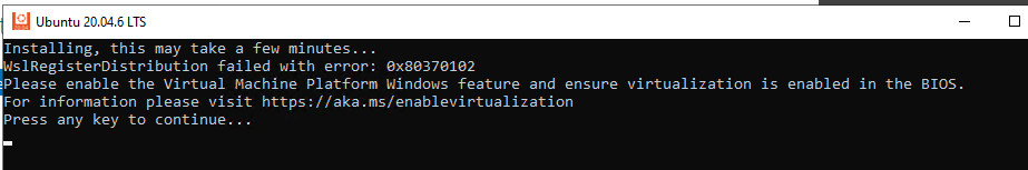

I am trying to run wsl. I am getting this error. User's image
Please help.
