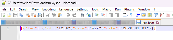

    The (input) JSON you provided has not the correct syntax, this should be:
    [{"tag": {"id":"1234","name":"viv","date":"2020-01-01"}}]
    There was a quote missing before the date. This could be a typo, so I'm not sure if this solves your problem.

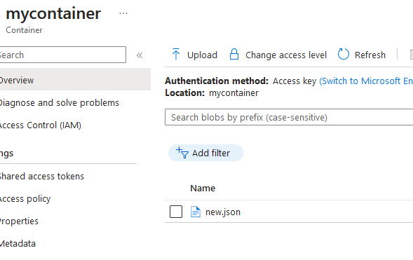

    Therefore I tried to recreated your setup with a storage account and a stream analytics job. I saved just a regular JSON (without compression) to the storage account:

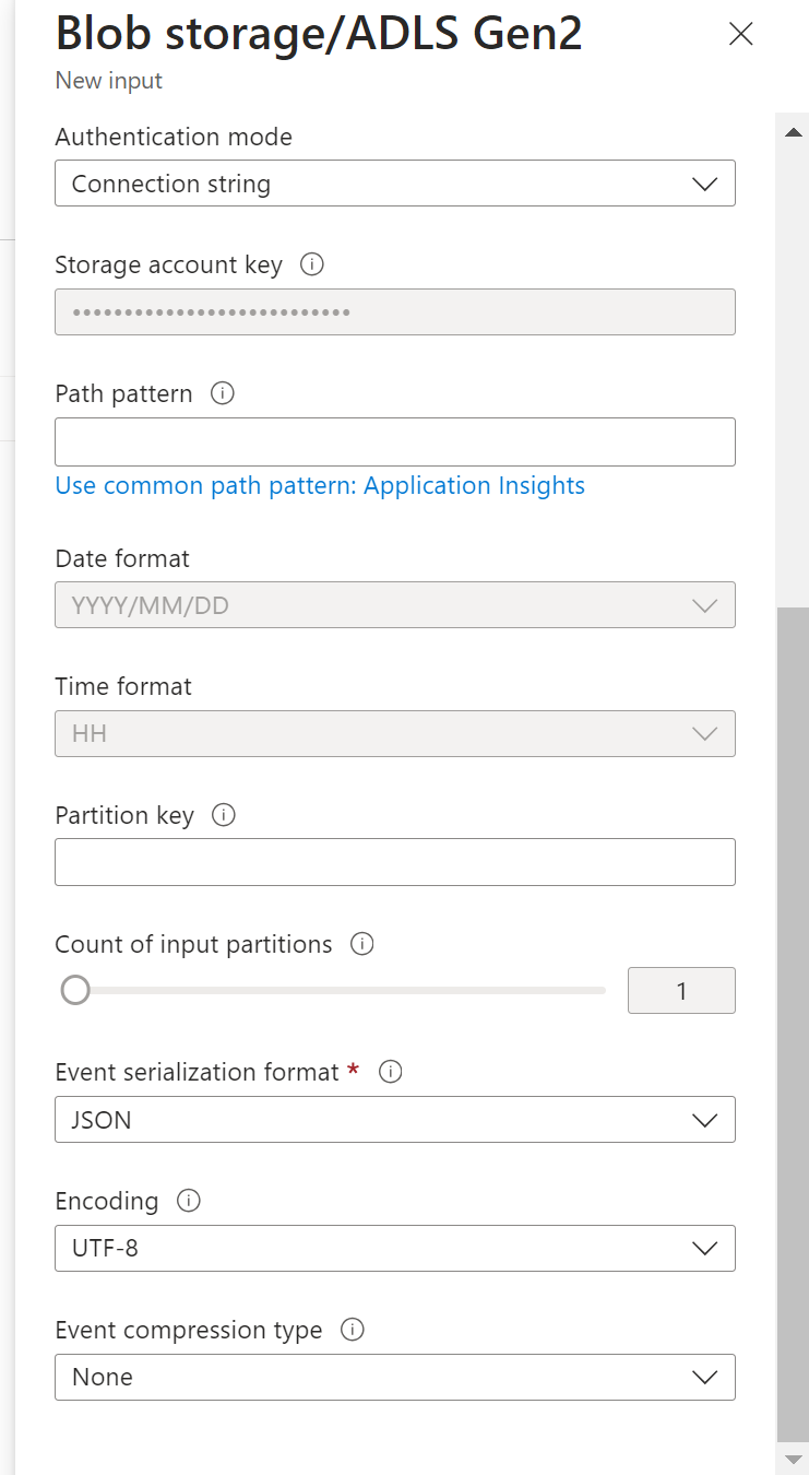

    Next, I created a input in stream analytics:
    When then looking at the preview of the input the content is shown:

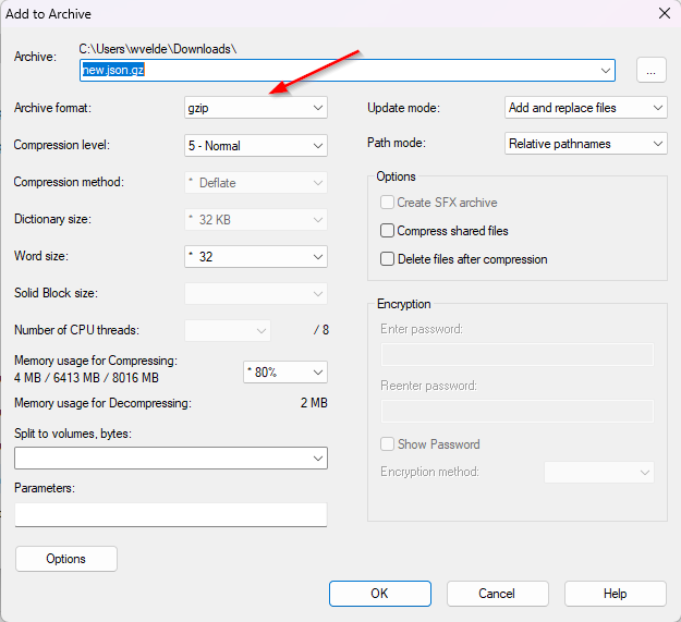

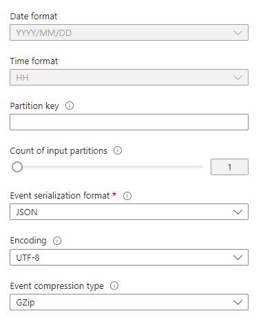

    So, try to save an example file in JSON into your storage account and test the setup with that file. If this works, this might indicate there is something wrong with the compression.
